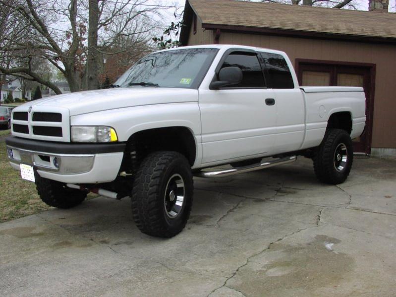

I have a 1998 1500 with a 5" lift, 315/75/16 tires, and installed skyjacker shocks. The ride is still stiff and hits the bumps hard. Is this because of the lift suspension or this is common for this truck. Track bar and link bars replaced and added dual stabilizer shocks. What will improve the ride?

Springs... some of the higher zoot lifts have progressive rate springs, makes for a MUCH nicer ride. Shocks just control the bounciness....
I drive a 3/4 ton that is empty more often than not... I just got used to the rough ride. Rides like a Cadillac with about a thousand pounds in the bed.

its probably a combo of the lift and with the new shocks and the tires. how much pressure do you have in your tires? give some times for your new shocks to wear in a bit. not very familiar with the skyjacker shocks but i wouldn't be surprised if they are rather stiff just from the nature of the fact that they are for a 5" lift.
these trucks don't ride like Cadillacs or new truck even for that matter. others will chime in with smoother shock options. also look at your tires 40-45psi will give you a smoother ride.

What type of SJ shocks are they? If they are the hydro shocks yep they hit very hard. When I just had the 5" lift and SJ shocks it rode hard felt every bump and crack in the road. I switched over to Bilstein 5100 shocks when I installed the 7" lift and it has a much better ride. What brand of lift kit is in your truck?

When I bought the truck the lift was on it and no brand markings, but it looks like tuff country or pro comp. As far as the skyjackers, it wasn't the hydro. I guess I'm just spoiled after having a lifted 02 Avalanche that had a smooth ride. It got totaled in an auto accident last year. Thanks for the replies

Long arms will drastically improve ride quality at that height. Progressive rates will help after you do long arms. Top gun customz has some nice ones.
