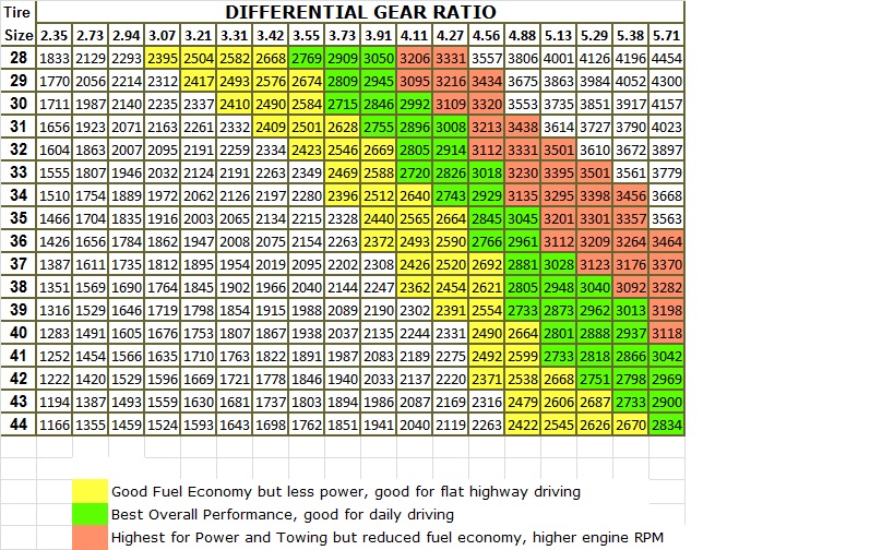

I think there is another module other than the PCM that works to calculate speed.
I found this last night....
