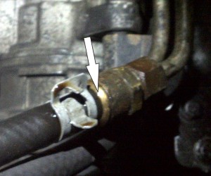

Well when I bought this thing the previous owner had the aux cooler installed and bypassed the main radiator.. Its a 22,000 gvw hayden cooler.. The check valve is on the hard line for the transmission right where the rubber lines connect and go into the cooler. Im not sure if he drilled out the check ball or something all I know is its either stuck open or drilled out because when the Jeep sits for a few hours the fluid drains out of the torque convertor or whatever.. If i start it up and drive it moves fine but itll act like it doesnt want too.. Well not want too but act like its low on fluid or something.. Then 2 seconds later its fine.. So what I do is put it into neutral to start the pump and then i can hear a whiring noise for a second or two and then if i let off the brakes itll roll backwords or foward without me needing to step on the gas..
Does this make sense ? So that tells me the check ball is stuck open or drilled out.. The problem is the checkvalve unit is still on the hard line.. So I dunno if its just stuck open or if its drilled out or what..
My check valve looks something like this one.. Im wondering if i should unplugg the rubber line and chop the thing off the line ? The only worry id have is if i put the rubber line back on after itll be on a smooth line.. ATM it has a barbed end to go in.. I'd be worried itll slip or blow off driving down the road.
Well, if it drains back into the cooler than the check ball has been drilled out. They don't stick open to my knowledge, when they stick, they stick with crap and don't allow the trans to get cooled oil.
