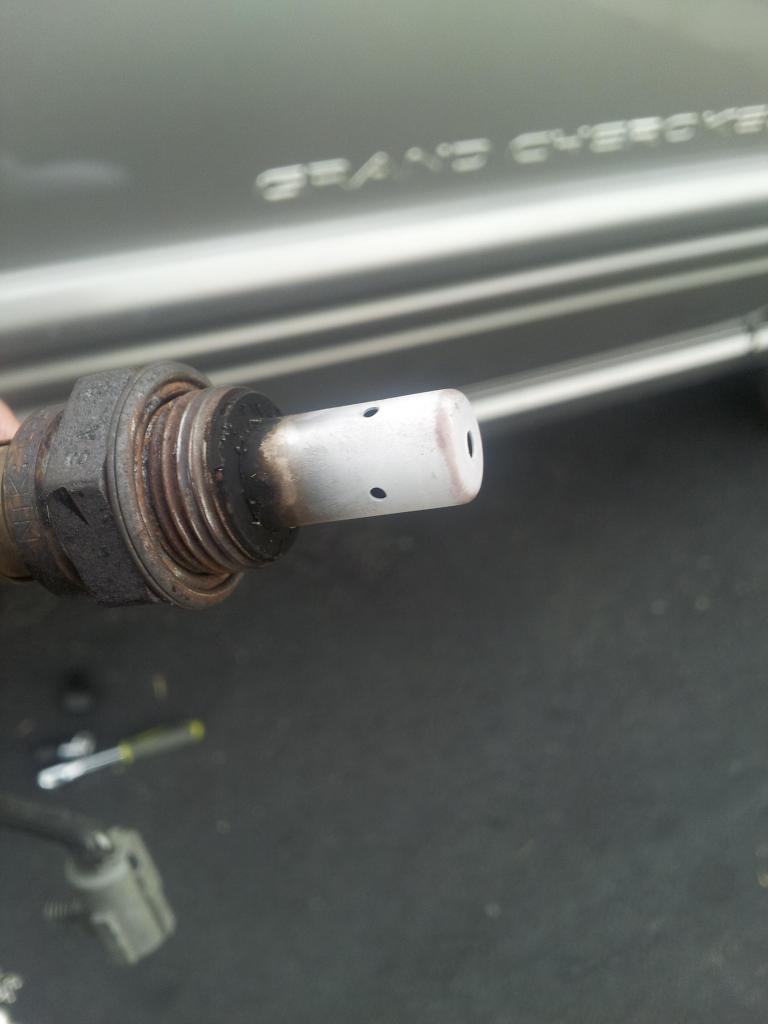

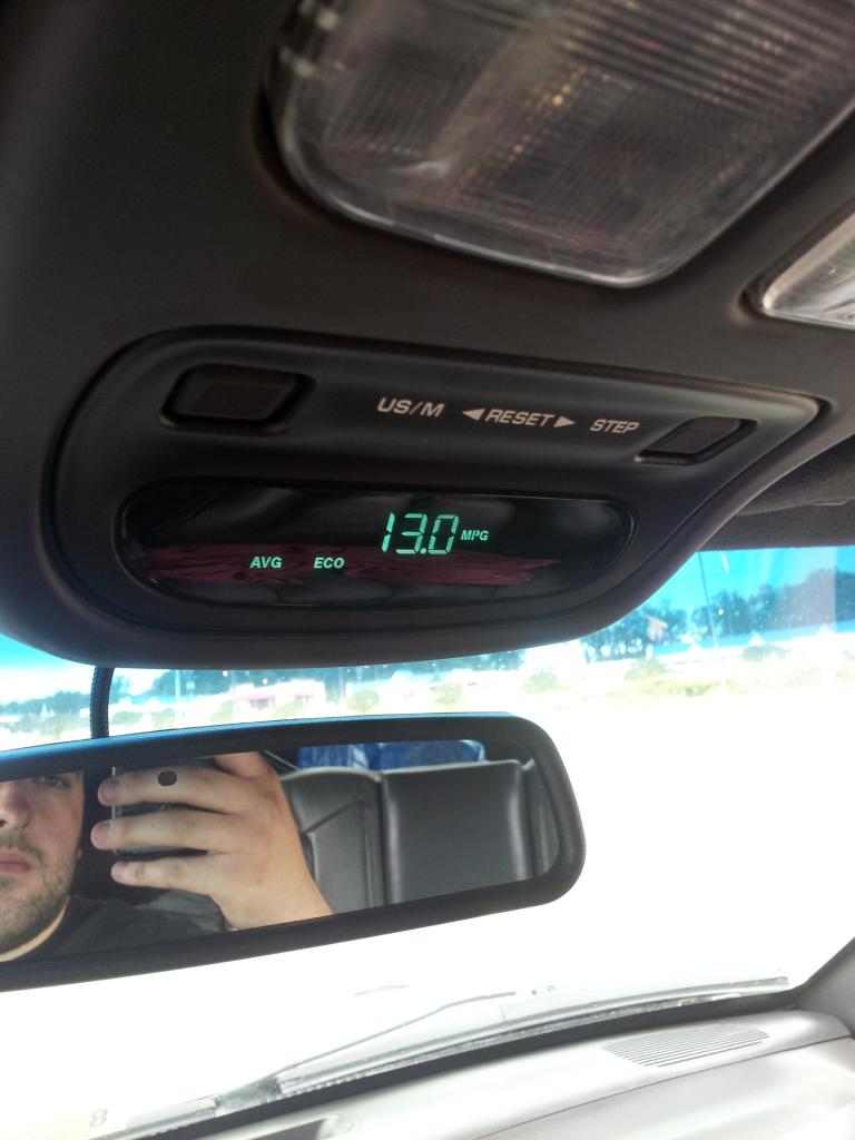

Here is a pic of my old one.. BTW why is the sensor all white on the tip ?? Is that normal ?? It doesnt really look dirty to me.. But i put the new one in and reset the computer and i drove around town for like 20-30miles.. and wow.. my gas mileage on the overhead is now showing 13mpg.. prior to this it was barely able to get above 10.5.. I dunno why i had to change the O2 sensor after doing my plenum but it seems so far like it has helped alot.. BTW how tight should I have made the sensor ? Because the booklet says 14-17 ft lbs for one sensor and 23-30 for another sensor.. But i couldnt get a torque wrench in there.. So i made it finger tight then got my wrench on it and tightend it like you would a spark plug.. because im really afraid to strip that since its only like 3 threads.. When i made it snug i tightend a little more and it started to move so that scared me so i tightend it more and it kinda stopped so it probly was just that washer it has on it compressing.. lol but i stopped.. I listend to it while it was running and i dont hear any whistling or see smoke comming out so i think its fine..
BTW the old sensor says NTK Japan on it like the new one does.. Did mopar use NTK sensors ? Or does this mean it was replaced at one time

You see that black on it? That's the oil crap from your blown plenum. It gets into the holes and keeps the sensor from reading properly. And yes, Mopar used NTK, that's why we all say to use it. lol

Yea I guess it is pretty black right there. the rest looks ok tho.. Im curious what im cat looks like lol

Yea i did see my pics ? I unplugged the pcm before i plugged the new O2 up, and then plugged the o2 up and battery and ive driven 45 miles so far in the city.. with lots of stop lights and lots of green lights.. My mileage atm is 12.7mpg.. I can easily get it to 13mpg + tho once i drive more.. The mileage is back to where it used to be many years ago.
Basicly when i first bought this Jeep 3 years ago i was getting 13.0 mpg or so EASY.. Then over the 3 years it slowely dropped and before i changed my plenum i was getting around 11.8mpg.. After i changed my plenum it dropped to 10.5mpg i dunno why still why it dropped... But changing the O2 sensor its back to 13mpg..
