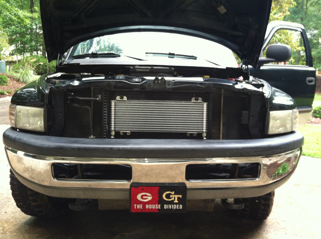

dhvaughan's Avatar
dhvaughan
Joined: Jul 2006
Posts: 12,204
Likes: 10
From: Gainesville, Ga.
Originally Posted by stewie01
dhvaughan has a thread around here somewhere, he installed a nice big diesel size tranny cooler...
That outta be enough
here you go: scroll to the end for the big one.
https://dodgeforum.com/forum/2nd-gen...ter-added.html
