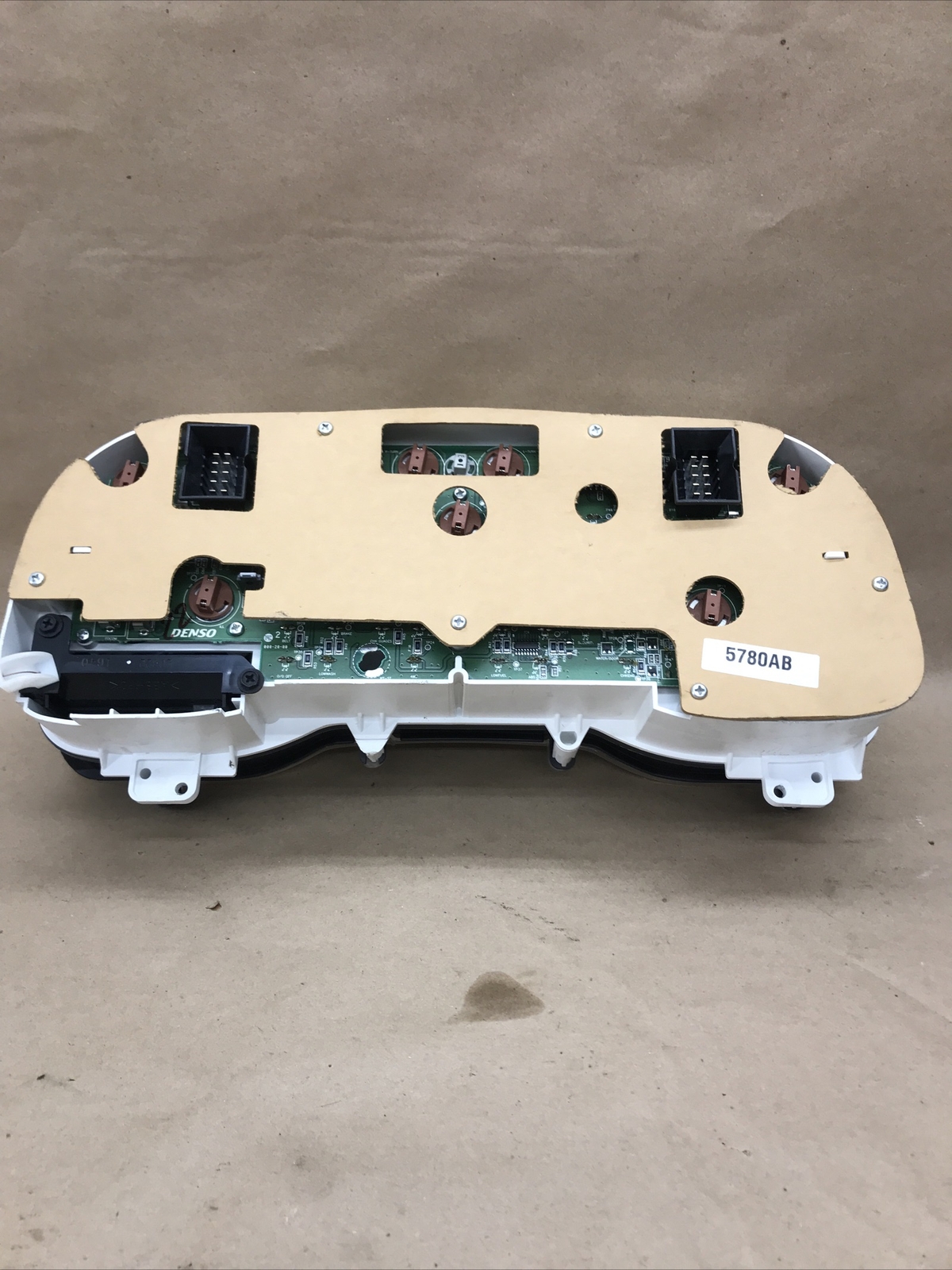

Here is a stock ram cluster

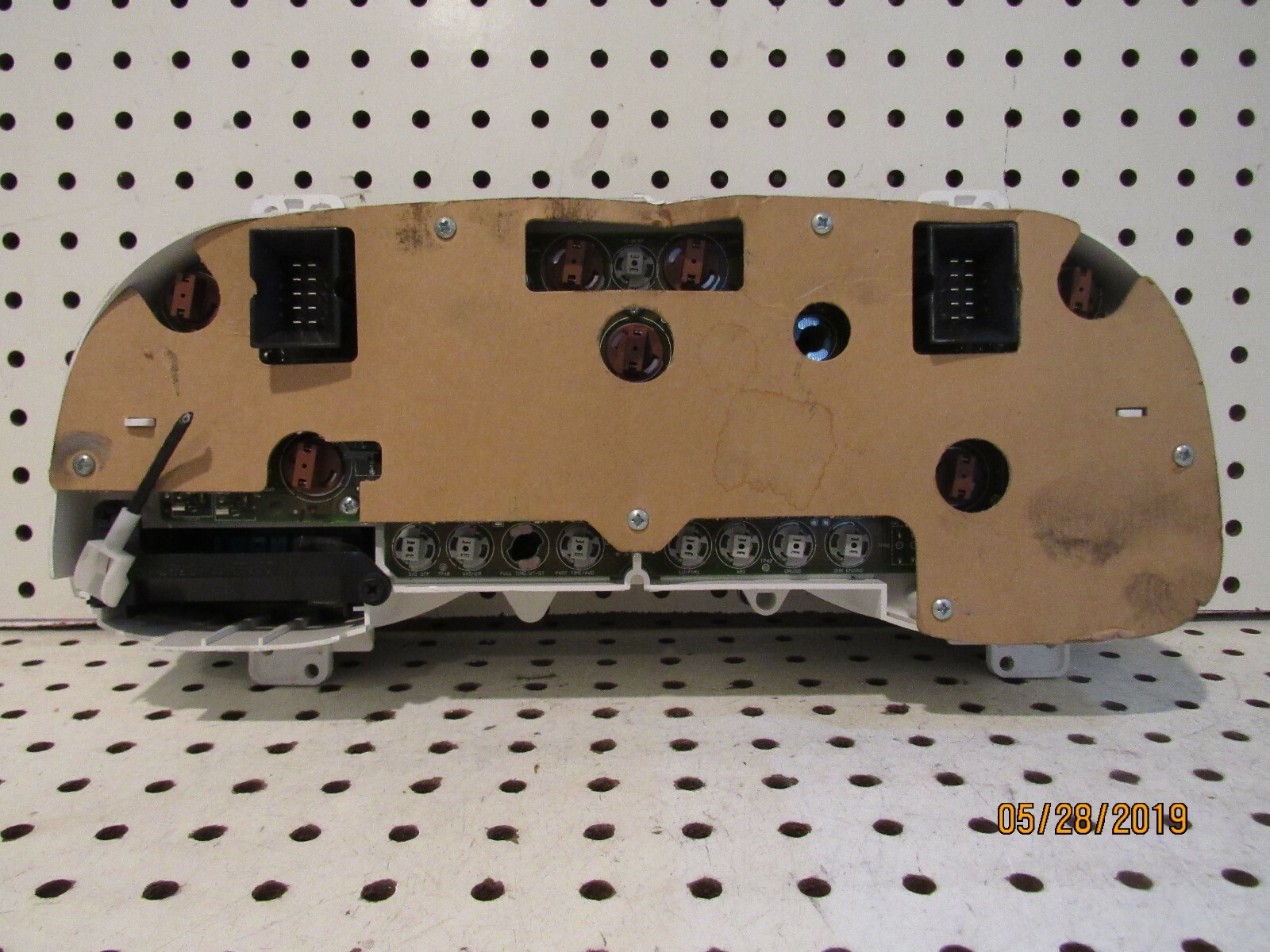

Here is a stock durango cluster
As you can see, the durango clusters appears to be nearly identical to the Ram cluster, other than the series of bulbs along the bottom. One of which being the 2 4wd modes.
Perhaps the cluster swap could be done and the switch on the 242 wired up in a factory fashion? Would the Ram ECU be able to do anything with this information?
