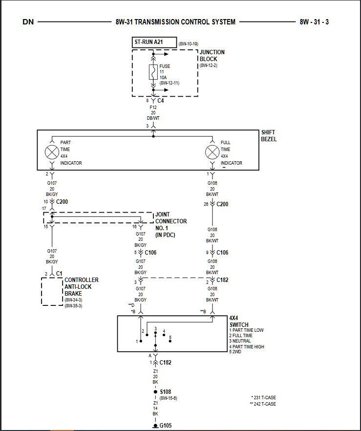

Alright, here's how the 4x4 lights are wired in a 1998 durango.

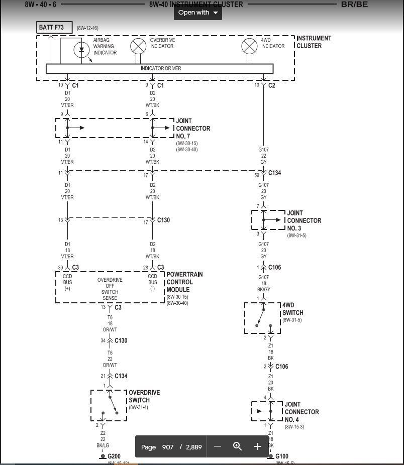

And here's the ram's

It looks like there are going to be enough differences between the clusters to make this fairly infeasible...but then again I'm easily daunted by electrical work...I just hate it.
I still think the swap is a good idea, but need to think up different solutions for displaying which 4x4 setting is which.

Put lights in the console to highlight which range you are in. On the full size trucks, the 4x4 light will be on regardless of which 4x4 version you are using, just have a couple lights in the console for Full time, or part time.
