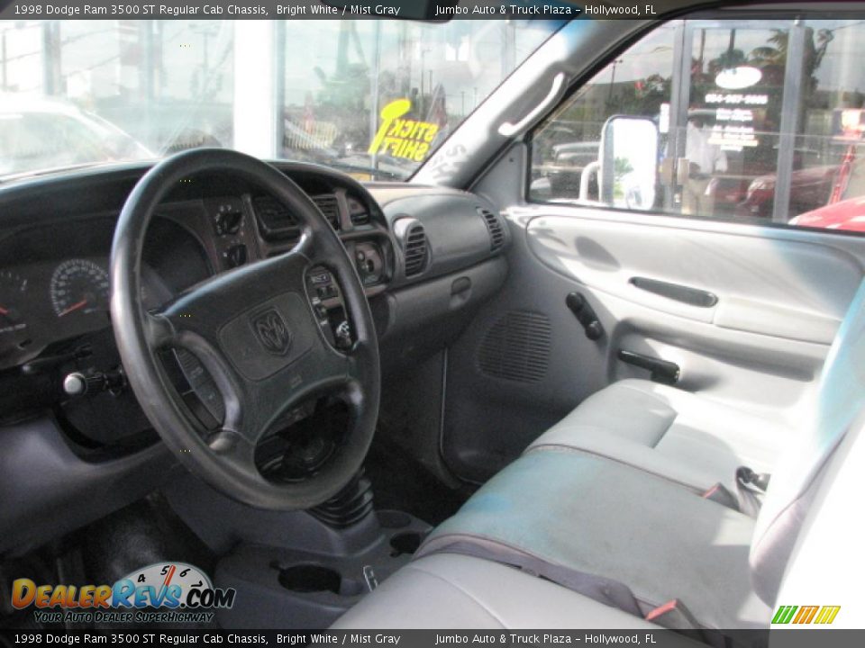

So with my truck having been rolled off the line in July of 98, that would make my rig a 98.5, right?
If you have the newer interior, yes. If you have the older interior, no. This is the most accurate way to tell the PCM type. Date of MFR is not an entirely accurate way of telling.
If your interior looks like the above, then you are a 98.5 (if gasser, of course).
If it looks like below, you are not.

I'm fully familiar with the differences between 97 and 98's, but considering Dodge introduced the Quad Cab in 98 along with a new interior, I don't see why they would have had two interiors for the same year.
And my door panels are different. Round speaker hole, not squaretriangle-ish.
