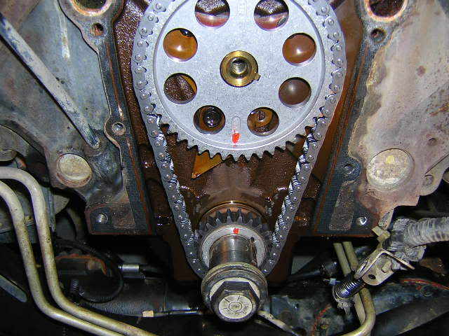

ok, does the distributor gear come out with the distributor, or is it separate? i don't know. i hope its attached to the distributor. if its separate, have you moved it?
the pic below is crank dot at 12, cam dot at 6, and this is tdc #6, NOT NOT NOT #1. note the positions of the keyways. and the crank can rotate twice to the cam, so that's how it can get 180 out.
if you can get it back close enough to crank, you can google fuel sync and maybe get it close enough to run. i think you can attempt to crank it with the water pump and timing cover off of it. just don't let it run but a moment with no water.
