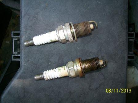

Checked #5 and #8 plugs have pic below. found a little fuel on #8 but nothing major, checked spark on both cylinders with spark tester and have spark jumping 0.50" gap (plugs set at 0.40") so I've got good spark. Pulled Front O2 sensor, no change aside from noise level which was expected. only thing that has changed since doing IAC change is truck is now idling around 1,000 to 1,100 rpms, which is where it's always ran at since we bought it, but still idles rough.
