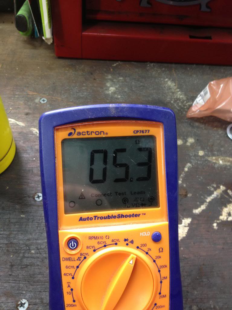

Unhooked both sensors yesterday and measured resistance with a volt meter thingy.
Drivers:
Passenger:
Both readings are in ohms.
Both readings were taken when sensors were cold.
service manual states that I should be seeing a resistance of 5-7 ohms across both white wires. Doesn't specify hot or cold.
Is the passenger O2 reading too low for the PCM to register?
I am getting juice from the harness at each O2 connection point.

Not that i am aware of....please elaborate.

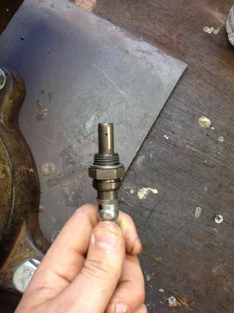

Date of manufacture: 11-95.
I took a look under the knee bolster and found the OBD II scan port zip tied to one of the dash supports...? Must have been from original owner.
Hooked the scan tool up to it, live data showed no change in output from sensor #1, along with a P0132 code.
Replaced the sensor and all is good. It's finally running like a V10 again.
No more stored codes!!
I was under the impression it was OBD I.
Thanks a ton HeyYou, never would have gotten that without you.
