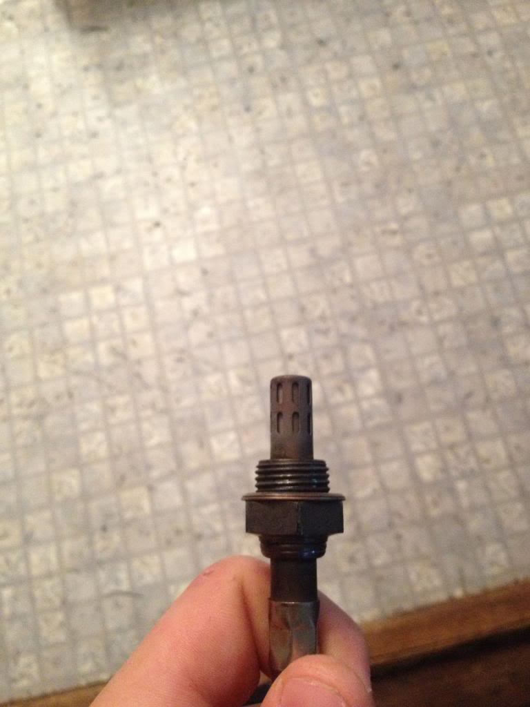

As for the sensor wires being different lengths, this is the sensor attached to the 18" lead:

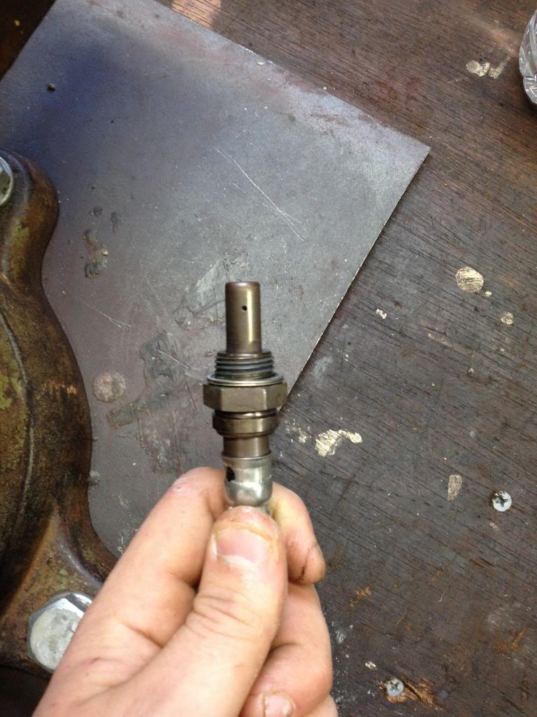

Tip looks alot different that this one (12" lead):

I'm not doubting that they do the same job, I am just making an observation that the tip that goes into the pipe on the 18" sensor that I was sold is different from the 12" sensors that I am currently running.
Could have been bad out of the box, or it could be the incorrect sensor.
