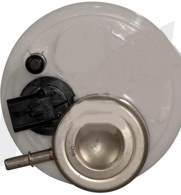

did fuel pressure reg.test; tested over 90 PSI.- so repaced complete fuel pump cause of time.
In my truck the old fuel pump unit does not have one(rollover valve), according to mannual I am using it should ,but ordered one in exactly like what I took out.
It has electrical connector to fuel pump & hose connects to regulator.
bought used 2 years ago - could this be correct?
35 gal tank
2001 dodge 1500,6 cyl. 3.9 -door sticker states made in 04/2000-
last 8 didits of vin 1S708369
other problems arising - just want to make sure I am starting out correctly before more parts.
thanks in advance-great site

Our fuel pumps are a pump/regulator/check valve assembly. The pump is all you need.

is that check valve /pressure relief-rollover valve the same ,and if so is it located elsewhere on the fuel tank?
for it is not on top of the whole assembly of fuel pump.

sorry i did not make clear,the truck has run good for 2 years, it started acting up, replaced exactly what was in the fuel tank- ( instead of waiting for the fuel pump to go out).could it be possible someone put in the wrong assembly 2 years ago? how would it run for 2 years? ......did I by someones mistake
if this is the wrong part.... again where does the pressure relief HOSE(rollover valve HOSE go to if there was one?)
here is a pic. of what is in the truck.

Grab the 01 service manual from the FAQ section here. (in the service manual thread) On page 14-6, there are illustrations for fuel tank connections. Apparently, there were three different tanks used. 26 gallon, 34 gallon, and 35 gallon. The 26/34 gallon tank actually shows the rollover valve. The 35 gallon tank doesn't appear to have it. Which tank ya have on your truck?

You have the correct pump installed.
