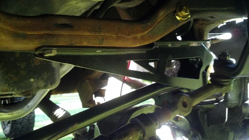

If you have acess to a metel brake and a tig welder the frame bracket is very ez to copy or make better.
Some pix of it, if you need a more detailed info I can go measure it every which way for you.

This is the spare track bar I have.
