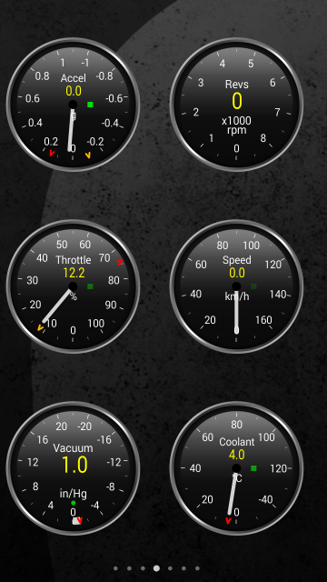

I have the Torque app and the adapter. Do you know if it will test it? I know when the truck is idling the torque app shows 12.2 on the throttle like it's open partially.

Should work great. It is basically a scanner. Gotta love it.
some voltage even at idle is normal. What you want to see is that value going up smoothly, and steadily as you step on the gas. if it bounces around, or doesn't change for any period of time when stepping down on the gas, time for a new one.

Here is what Torque shows about the throttle. It says it's a % not a voltage not sure if it's correct tho. First pic is idle and second pic is WOT. If it is actually a % then it says I am only at 74% throttle at WOT and that would explain a lot.
This is at idle.

Ah, the app reports percent opening, as opposed to actual voltage from the sensor. Might have to whoop out with a meter to properly test it. Should be under 1 volt at idle, and greater than 3.5 at WOT. (with a smooth sweep in between.)
