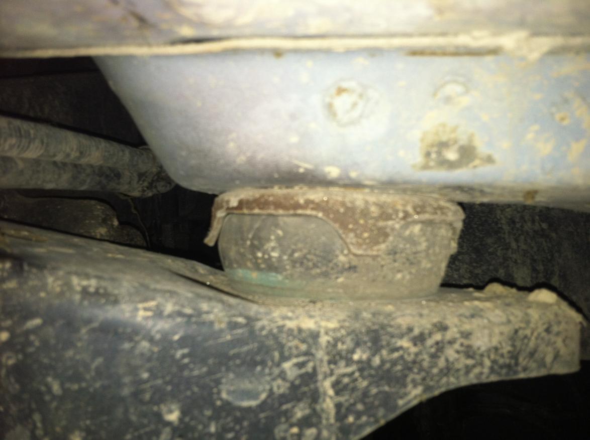

bought a 99 dodge ram 1500 4x4 trying to tell what size lift I got
has 315/75/16 tires
front and back bumper height is 27 inches
from top of tire to wheel well is 12 inches
front coils are grey and don't think there is any spacers
has 2inch and 4 inch blocks in the rear
Attached Thumbnails help telling what size lift i got-img_0126-1-.jpg   help telling what size lift i got-img_0127-1-.jpg   help telling what size lift i got-img_0128-1-.jpg   help telling what size lift i got-img_0129-1-.jpg
Old Dec 1, 2013 | 09:16 PM
Posts: 87,403
Likes: 4,214
Probably a 5 inch lift. Most kits also level the truck, so, the front comes up more than the rear.
Body mount looks stock.
