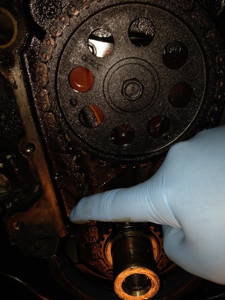

*Always* change timing chains and gears as a set.
When I changed mine last weekend (at 126k miles) it had developed a good 3/4 inch of slack. There were no symptoms of a bad chain, but since I was changing the water pump, might as well. Why wait until it breaks?
Also replaced the front seal as it had a slow drip... Interestingly, LOTS of sludge on the back side of the front seal. Never would have known if I hadn't checked.

That's pretty nasty in there...... need to change your oil more often.

Sadly, it came like that, though not as bad as this guy. The valley was pretty clean at least. Every time I turn around I find more neglected maintenance on this truck. I've been thinking about running some ATF through the oil to clean it out, but am kind of afraid as to what gunk it might break off.
