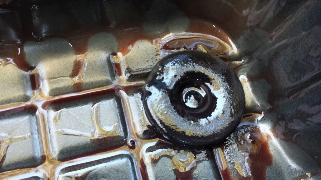

I recently (within the past 1,000 miles or so) did a filter and fluid change (not a flush!), and installed a drain plug. The magnet in the pan had a fair amount of black "sludge" on it, but no metal shavings whatsoever (photo below). Since the fluid change, I have not really noticed any difference in the shifting behavior. So, from the extensive reading I've done here, it appears the next best things to try first would be:
1) Check the TV cable - it appears to be adjusted properly, but I'm not totally sure. When the gas pedal is totally released, the TV cable should have just a slight bit of tension, right?
2) Try adjusting the bands - I have never had this done since I've owned the vehicle
3) Replace the governor pressure sensor and solenoid - these are both original

Attached Thumbnails 2001 Ram - Transmission question-20131227_154711_resized_1.jpg
