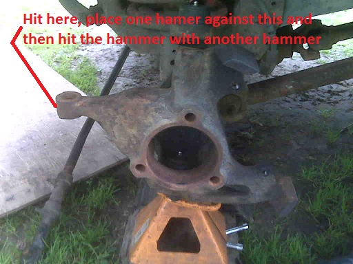

This might help explain what HeyYou is describing.
Thanks for the picture. That's for the outer tie rod though right ? I assume same idea applies though?

Anytime Sir. Yes that is for the outer on a 4wd truck. Yes Sir same thing applies to the 2wd trucks.

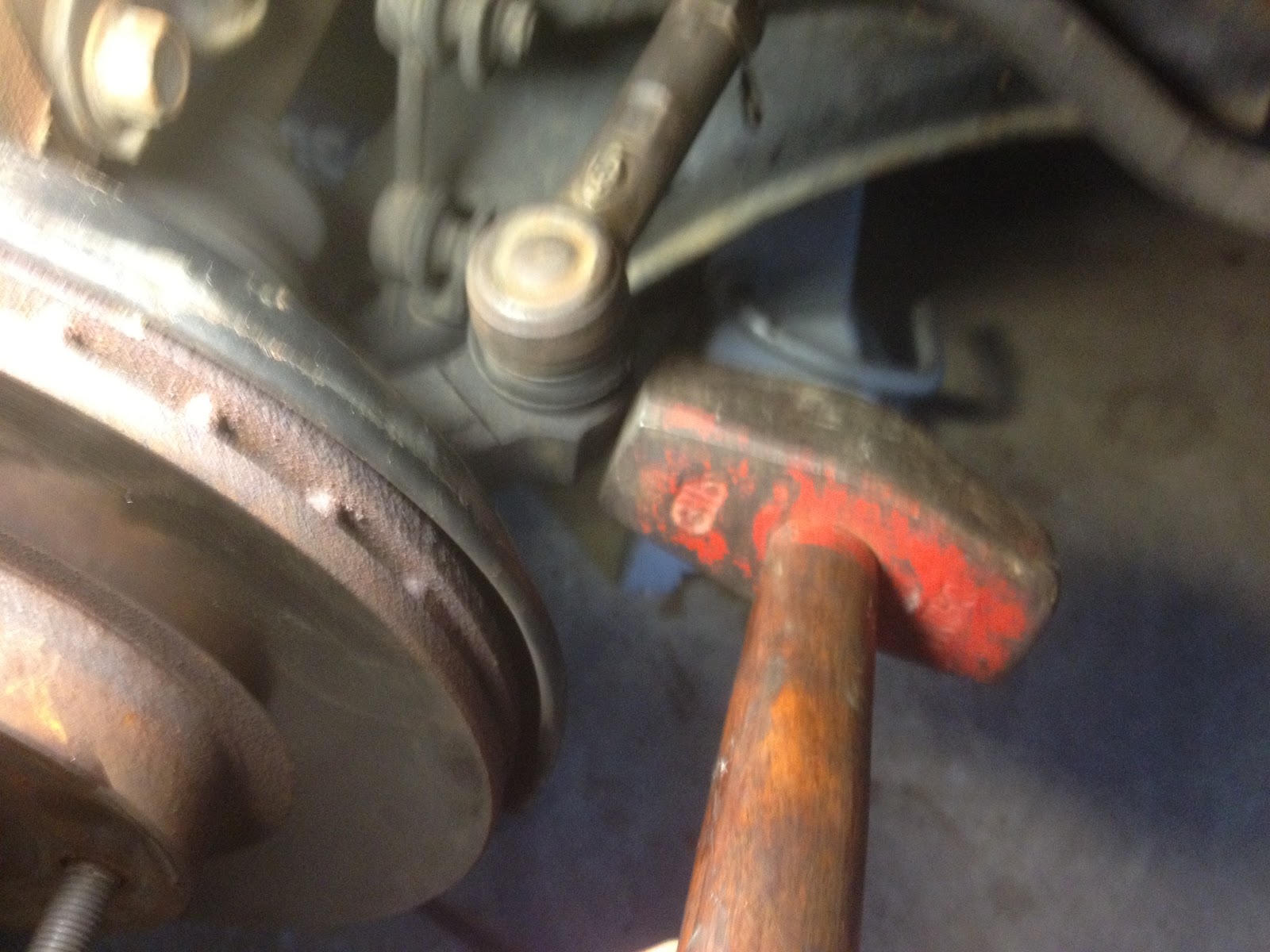

Must not be holding your face right, or, not using a big enough hammer.
This is what ya wanna do.
