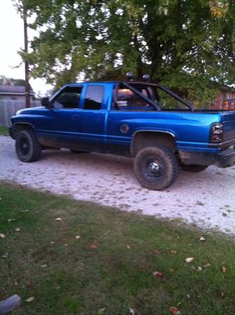

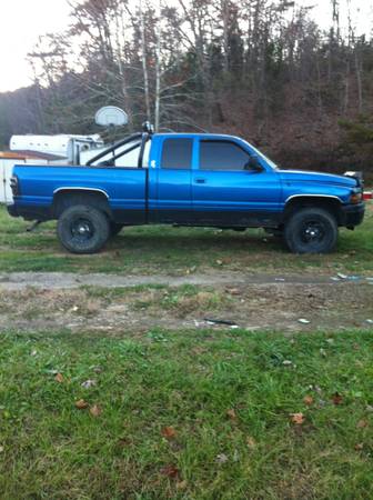

I got my work cut out for me though. The dash board is busted up, somebody wired in a trailer brake in a very unsafe way so I got to fix that. I am going to need to do a inventory of things that need replaced immediately and what I can replace as I can.
Here is some pictures!
Attached Thumbnails 1st dodge 4x4-00p0p_3cq65cen7eb_600x450.jpg   1st dodge 4x4-00h0h_bdnnjnktmhy_600x450.jpg

This doesn't really answer anything as to what you posted about but I like that rich blue color it has!

Funny you should say that I got a local transmission guy who will rebuild the transmission in it and gurantee it for 2 years unlimited mileage for $800. I am really thinking about going this route. BTW my truck is a very different blue than what the dodge trucks came with from the factory. Turns out this truck was professionaly repainted (the truck was originally white) however, the only spot you see the white color is on the fire wall.
