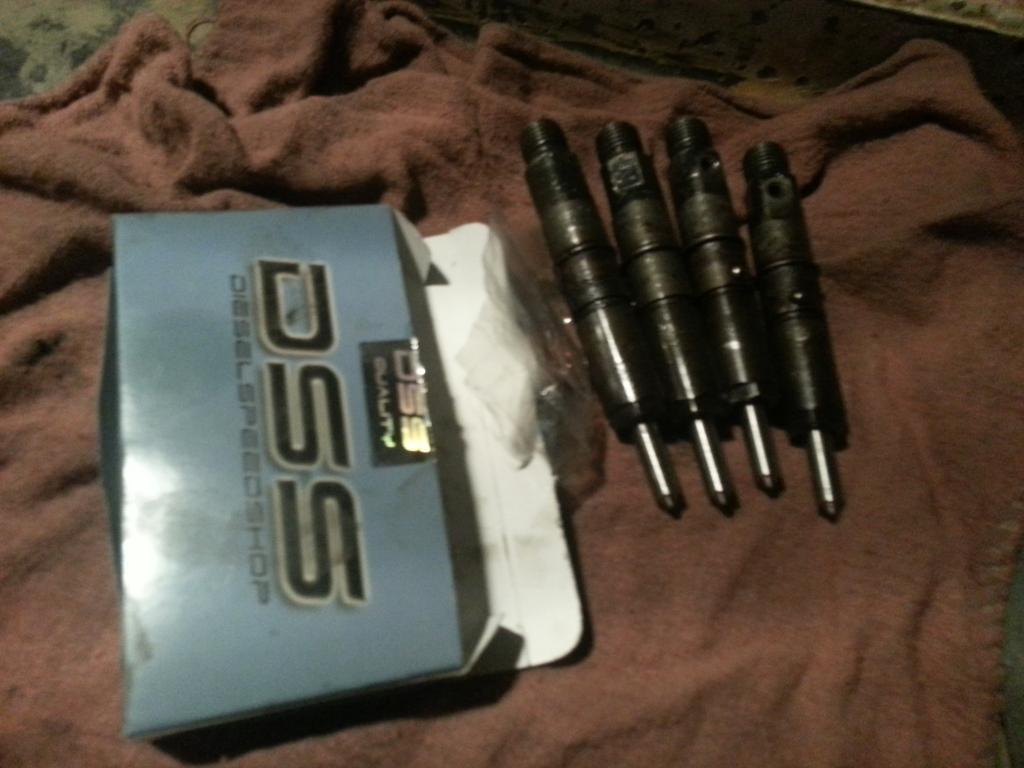

got the 5x16 injectors built and installed this morning, it made a good deal of difference in power,
before with a power break, it would spin the tires just a bit but not much in 1st, i tried it this morning and it smoked them right in to second gear and i backed off as i could see the dollar bills flying off the brand new toyo m/t's lol
now i can make heat though, so its time and i have incentive to get going on adding the second turbo, i want to play with the injection pump a bit more but not going to do that till i get the other turbo on and get it cooled off
just finisehd up the injctors

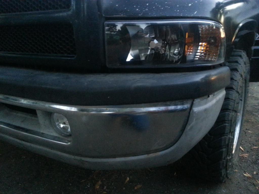

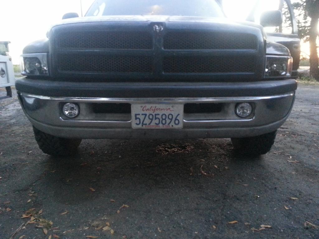

finally got the headlights and fog lights finalized, new one piece black housings with a new set of silverstar's, and the fogs were a complete replacement with bracket, lense, and bulb, for $37 i couldn't beat that! and with a jumper in place of the relay, the fogs will not shut off with the high beams, (it had factory fogs, just never had lights when i got it) and i have a jumper in the coloum that keeps the lows on also with the highs, this thing puts out plenty of light now
