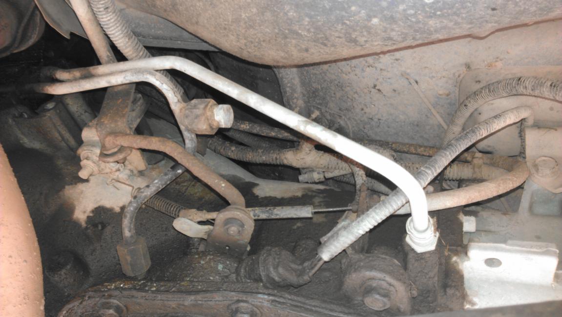

I am not sure if I have a temp sensor or not, I have been looking and am not really sure what to look for. Here is what I am looking at:

You have the lug for the sensor, but, the sensor itself is either broken, or, simply plugged. It is on the lower line there, just above where the shift linkage hits the trans. Check and see if that really is the sensor. Looks like the connectors may have broken off of it.

So the temp sensor is on the actual line, not connected directly to the trans? I am assuming you are talking about the cooler line that starts left of the shift linkage and goes behind it, then up to that 'ball' with the lug on it... correct? I appreciate your help!
Old Apr 25, 2014 | 09:32 PM
Posts: 87,552
Likes: 4,230
That would be the feller.

Just went and checked it. I did not see any wires that were broken/not connected. It seems to be a simple bolt that was just inserted, so I am assuming it was just plugged. Since I was getting the 37-code, that is why, correct? Also, even if I bought a new temp gauge, I did not see any wires to hook it too.

They may be stuffed up on top of the trans somewhere. May have been cut off too for that matter..... Does your truck have the tow, or heavy duty, or plow option package? (build sheet will tell you.)

Any one of the three packages I listed would include the trans temp sensor.... if you don't have any of them..... wouldn't be the first time a computer whined about something it never had. (I have seen folks getting knock sensor codes, and these trucks NEVER had one.....)
