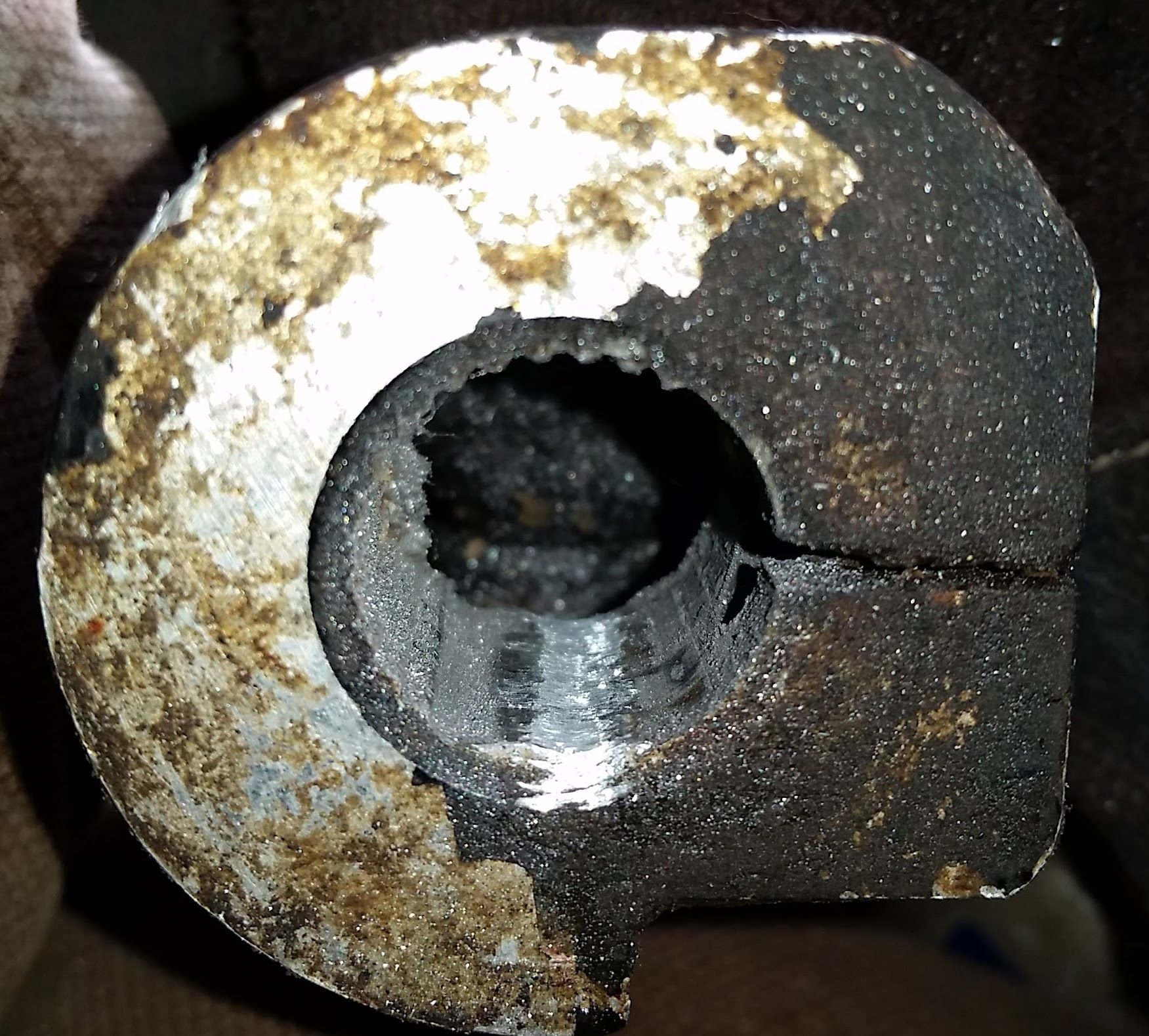

In case anyone is still doing this modification with the Borgeson aftermarket box, I HIGHLY recommend it. It was the only thing that truly fixed the steering play in my 2001 2500 and I have been happy since I installed it over two years ago. The instructions provided by Borgeson are reasonably good, but I wanted to post a bit of a write-up for a few things I think it is lacking.
First, using one of the four flat spline grooves as a reference, I found the center point of the steering box by scoring the outer casting with the output shaft turned to the extreme left and extreme right and measuring the halfway point.
After removing my stock I-shaft, I found it to be tight as new. Literally, no play whatsoever. Also of note is that it has "Made in Germany" stamped on the rag joint. I don't know if that means just the joint or the whole shaft.

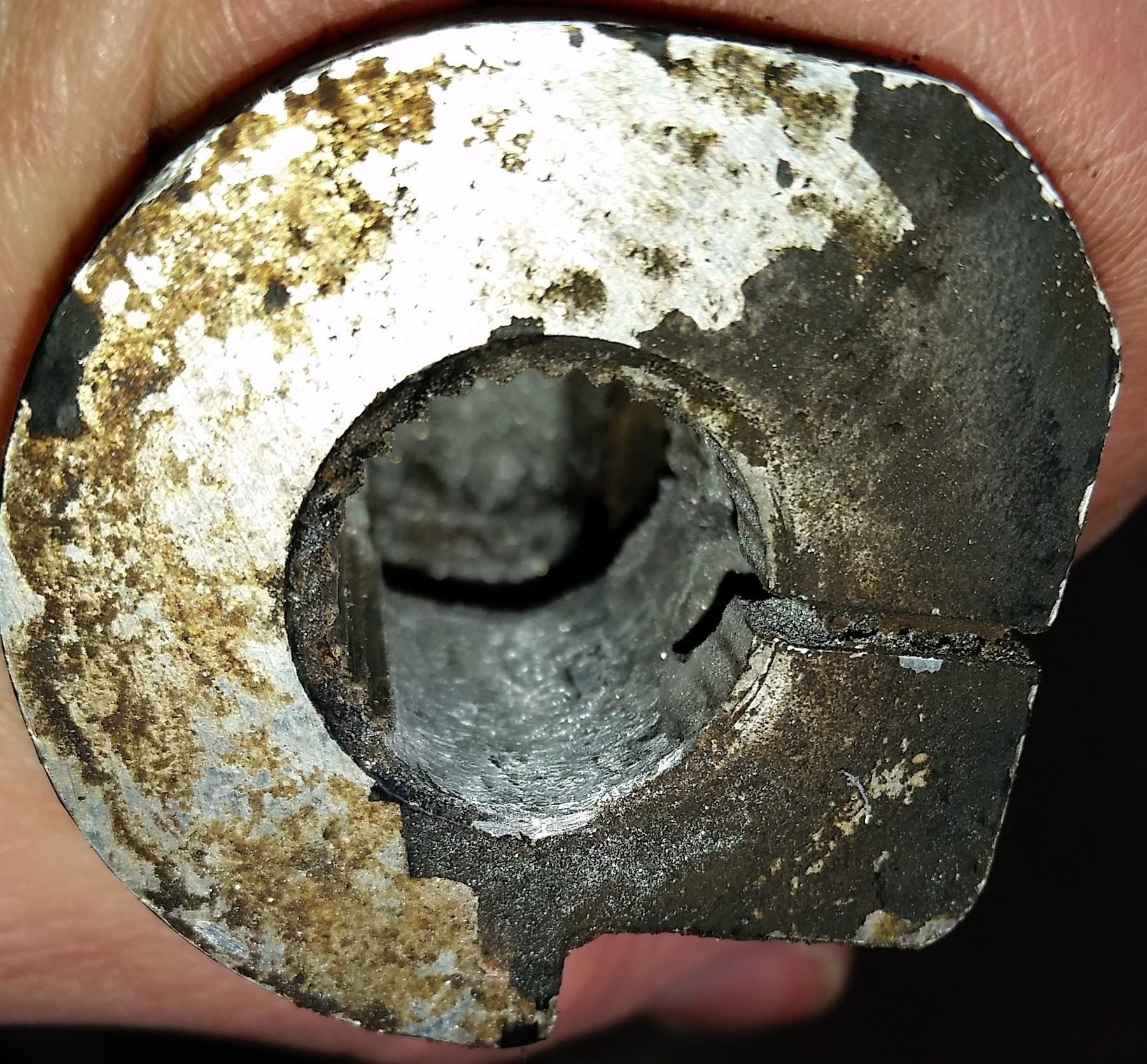

Borgeson’s instructions state to grind a flat on the 30-spline input shaft of the new box if you are going to reuse the stock shaft (which, after seeing what great shape it was in, I decided to do). However, I went about it inversely. Instead of grinding a flat on the box, I ground out the “D” inside the lower U-joint of the OEM shaft with a Dremel.
Shaft coming out of borgeson box
Before: flat on I-shaft
Making progress: Grinding down flat on I-shaft
After: Ready to use on Borgeson box

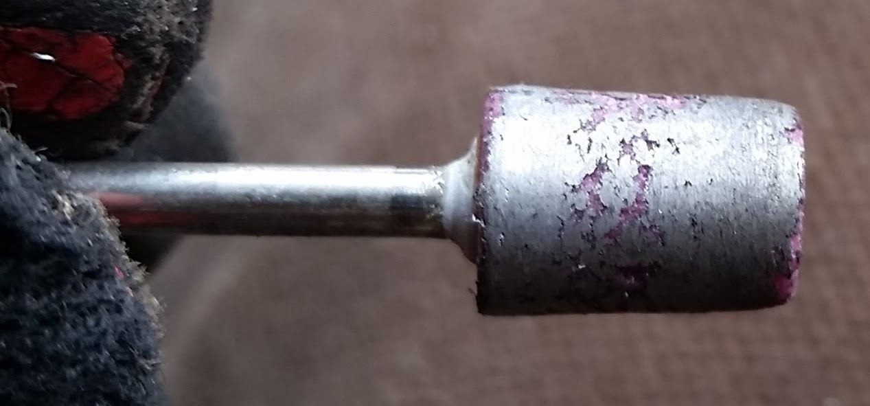

This dremel attachment filled up with metal too quickly
This dremel attachment worked much better
This method offers two benefits:
1. If I decide to upgrade to a Borgeson I-shaft, I still have all 30 splines on the box.
2. I don’t need to worry about grinding a flat in the exact correct spot on the box, since I can put my modified OEM shaft on in any orientation.
