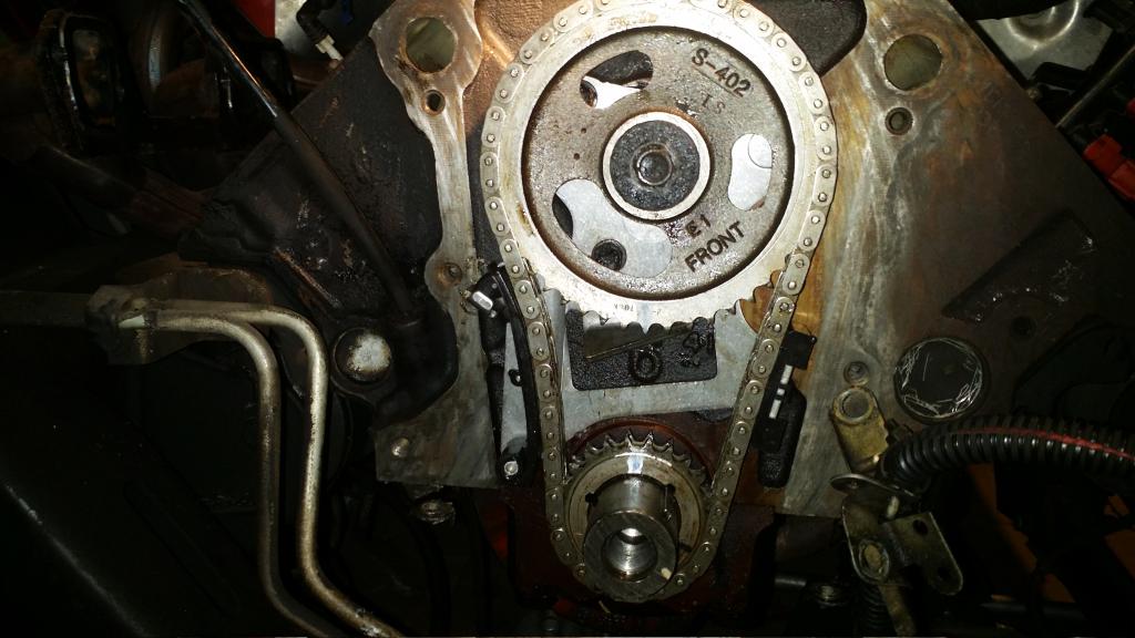

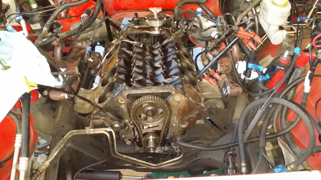

Dizzy not quite alligned but my marks line up
Timing installed straight up at 0, cam dot is top middle , not visible in this photo.

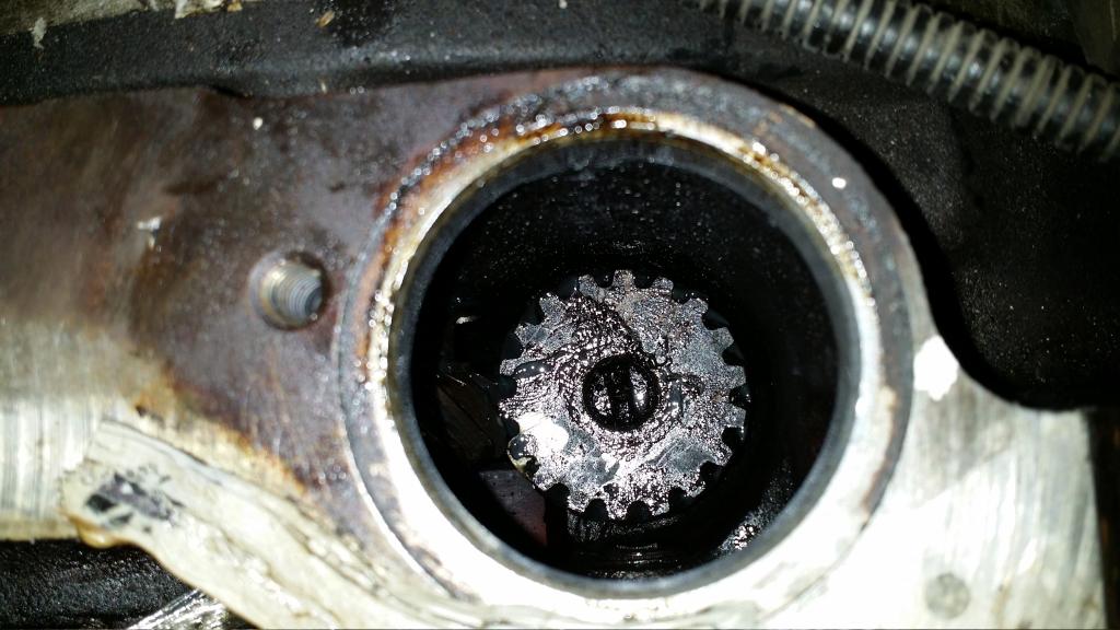

Dizzy gear slot pointed toward no. 1 cylinder

Should be fine. Just make sure to set fuel sync once its running. (need a pretty good scan tool for that.)
Also, with the timing gears dot to dot, I think number 6 is actually in firing position.

So leave as is then? If I advance the distributor gear 1 tooth it all lines up perfect, or if I turn the ditributor body slightly it lines up perfect. Guess I'll leave it as is and if needed rotate the distributor slightly if no start occurs.
I have both dots pointed up on the sprockets, painted the bottom for visual aid only. Number 1 is at TDC, both valves closed(intake valve just closed), harmonic balancer mark at 0, distributor rotor pointed at number 1.

The distributor position is not that critical, as the crank position sensor triggers timing (controlled by the PCM)... the distributor just says which cylinder is getting the spark... so long as the rotor is pointing to the correct pin in the cap, you're good.

hey beau680. Yes my install fired right up. Distributor gear direction is not that important. But you should try to get the gear pointed as close as possible toward the number 1 intake bolt. You can rotate the distributor the rest of the way so that the rotor is pointed EXACTLY at the mark inside the cap indicating number 1 plug terminal. Do not change the order of the wires to compensate, just rotate distributor till it lines up.
This only works with number 1 cylinder at top dead center and the mark on Harmonic balancer lined up with mark on timing cover.

No you have it all wrong, fuel injectors are timed and controlled by the distributor, if no1 mark INSIDE the distributor is not lined up with rotor and you have changed location of your wires you will be squirting fuel out of time, it will never run correctly. Take a moment to think about that.
You are not lining up the rotor to the no1 intake bolt, that's the distributor gear that lines up there. Have a look at the photos above.
The ROTOR should be pointed at the mark INSIDE the distributor marked 'no1', also pictured above. Turn distributor to line them up exactly then you will have a chance of it running. I would put motor at TDC and realign that distributor drive gear if it was me.
