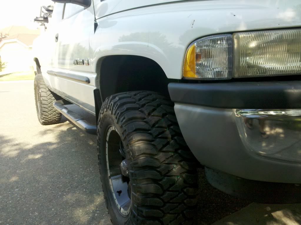

Here are some more pics to help you out.
Helo Maxx 6 wheels -- 17x9 4.5" backspace and -12mm offset
Mickey Thompson MTZ 33s
No rub and sit like armynurse from what I can tell.
Helo Maxx 6 wheels -- 4.5" backspace and -12mm offset
thanks for the additional photos, are your wheels 16x8's as well?
ooopsie.
edited the post.
they are 17x9
ok so that is the dimensions of the wheel i ordered, it doesn't look as bad with a tire mounted on it as it did just the rim. so if i exchange for a 17x8 with 4.5 backspace and 0mm offset it would pull it in an inch from your stance correct? Thanks again
