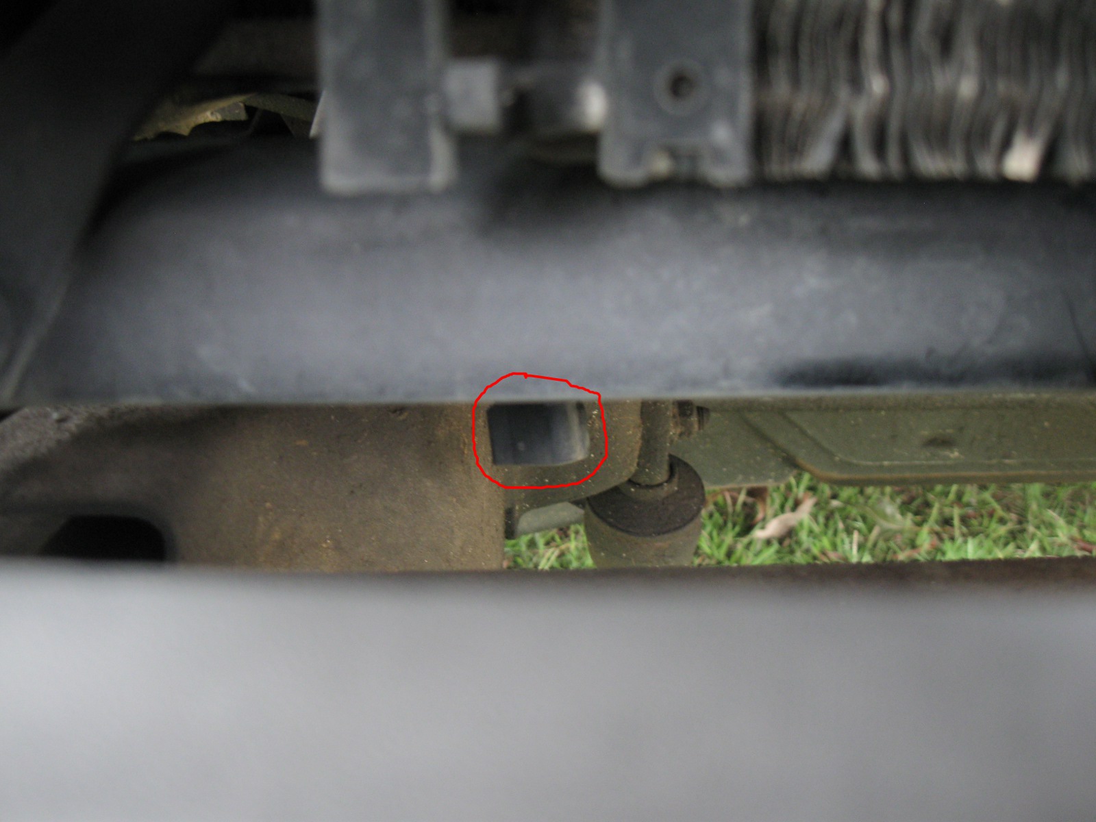

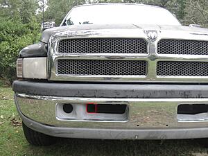

I can see it through the area of the sight shield I circled(squared?) in. Hopefully, they're clear enough to illustrate where it is. Apologies if they aren't.

One other thing, I only found the one oval-shaped connector on the truck. All the aftermarket foglight harnesses I've seen need two harnesses. Does the Dodge harness actually control both lights from the one harness/connector, or am I missing something?

Yep, that's the chassis side connector for the 4wd switch, which, being 2wd, you do not have.
