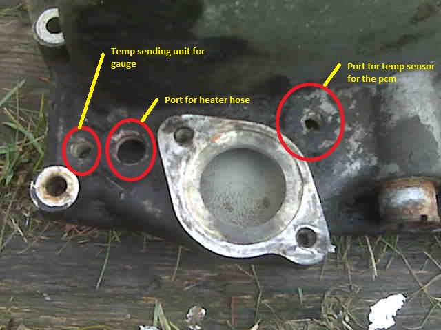

This might help

98 won't thats why HeyYou said to drill and tap, the pix gives you an idea where to drill and tap for the other sensor.
