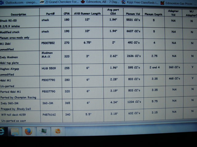

Old Dec 25, 2014 | 09:55 AM
onegoodmason's Avatar
onegoodmason
Posts: 320
From: up north
Tested with Seanz J-600 flowbench

Originally Posted by onegoodmason
Tested with Seanz J-600 flowbench.
Thanks for the data.
