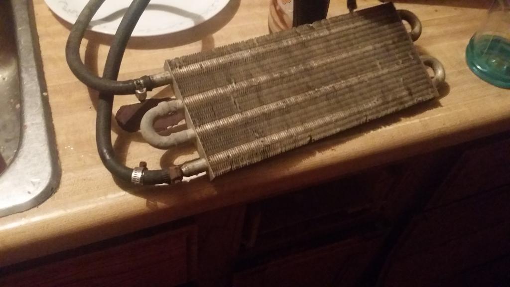

The other day I was on my way to the junk yard to grab a few panels & the rds were pretty slick well I ended up in a ditch with a hole in my trans cooler.My bumper was already pushed up against the trans cooler from the truck rolling into some trees . Anyways so I called the parts store they wanted over 200 bucks for one.So I was gonna order one from summit. But the wrecker yard said this one came off a dodge ram it dosnt habe the mounting holes & is a bit smaller.Its about as long as a ice tray plus 2 inches & as wide as 1 plus 2 inches.So will this work for me? Thanks

As an auxiliary cooler it will a little bit, as the only cooler not even close.

Its the cooler right behind the bumper that got a hole in it

The cooler between the radiator, and A/C condenser, (if equiped with a/c....) is an auxiliary cooler. If you tow/haul heavy loads, that one will be inadequate to the task. You want something meaner. (but, not necessarily the exact, expensive.... dodge part.)

This is the 1 needs replaced

You want something like this.
http://www.jegs.com/i/Flex-A-Lite/40...FQmBfgodCxwAaQ
