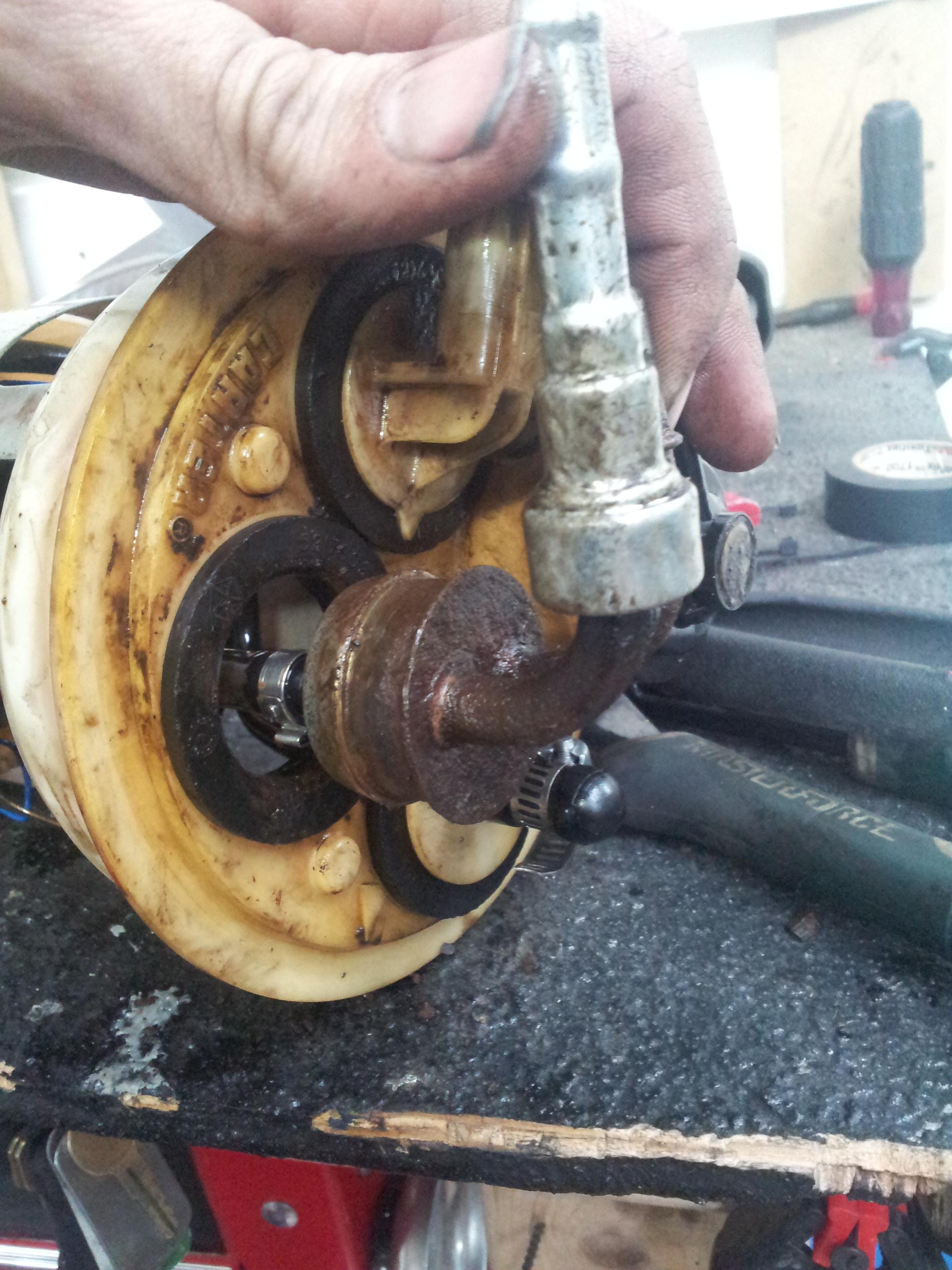

top of my fuel canister, these steel lines have dozens of pin hole leaks and im loosing 5+ gallons of fuel a day... well i just need this single part to fix it. the 90's look as if they were soldered in there (maybe) its so rusted its hard to tell. where can i get this part and what do you guys think its called?
imgur: the simple image sharer
it looks like a really simple FU**ing piece and yet no one at any dealership or parts store even knows what it is, let alone has one...

I don`t think you are going to be able to find that part by it self. You will probably have to order the complete fuel pump/sending unit, to replace it as one complete unit.

Filter/regulator I do believe. It's close to 100 bucks.... I would just replace the whole thing with new. (skip airtec, unless you like doing this particular job.)

Ditto on your last two replies.
