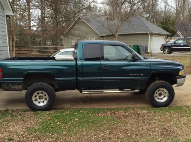

Let me know what think 3 inch rough country 33/12.5/16 16/8 American racing Baja 172 4.5
backspace

Looks good, like how I want mine, how was the installation?

May just be the angle the pic was taken at, but, it looks like the front axle is a bit far back. Good lookin' truck though.

Thanks guys and the front axle is good lol yeah the pic looks like it's back but no I'm way to picky about my truck to let that happen now maybe I can find center caps for it I chose hub centric rings over center caps wheel bore is 108 truck hub is 78.1 there would have been to much weight on just the lug studs new steering damper adjustable track bar and drop Pittman arm I think I covered all the bases thanks again guys y'all have a good day
