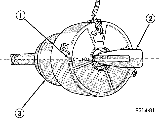

Yes, distributor is in wrong. There is a notch in the distributor body, and there should be a mark cast into the block as well. #1 needs to be at TDC, in firing position, (both valves closed), the rotor, the notch, and the mark in the block all need to be lined up. That should get you close enough for the engine to run, then, once it is running, fuel sync can be set properly with the appropriate scan tool. (if you don't have one, may have to take it to a shop.)
Rotor will indeed be pointed sorta toward #2 cylinder when everything is right.

Download the 98 service manual from this thread. On page 8D-24 is the procedure for installing, and correctly indexing the distributor. Follow that procedure, and you should be close enough for the engine to run fairly well. (doesn't matter what year your truck actually is, procedure is the same.)
