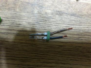

Have the same problem. Turned out to be poor connection to the coolant temp sensor. There is no slack in the wires and one pin was being pushed up and just barely making contact. Cut the plug off and added a few inches. Cranks right up. But now suffering from faulty iac... I hope. Also added spaces to the pins so they won't get pushed into the plug.
Attached Thumbnails 97 dodge ram 1500 3.9l v6.....-forumrunner_20150218_074740.jpg
