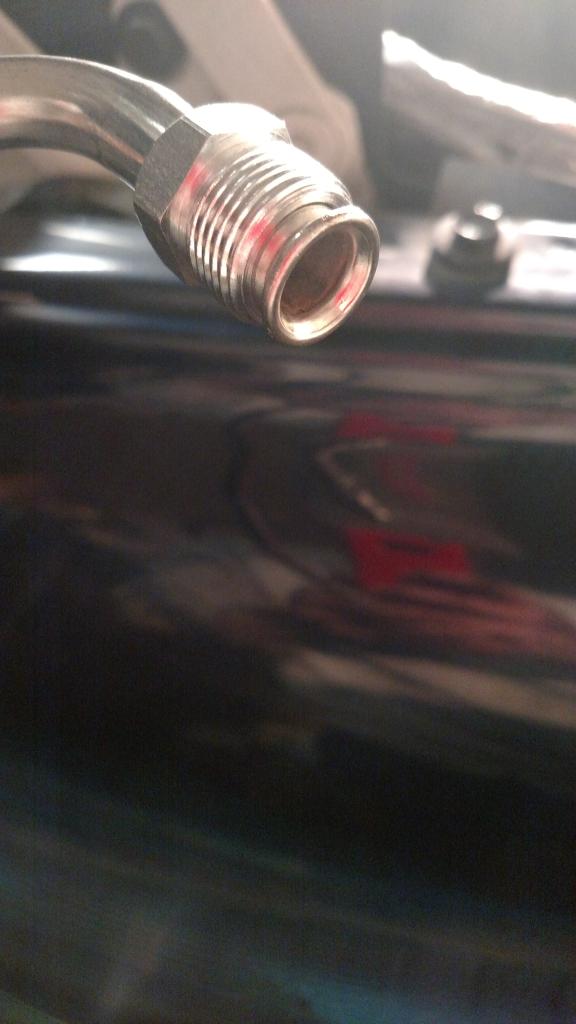

The thread does appear to be 1/4" NPT maybe a BSPT 1/4.
but the inside is a tapered flare and a o-ring seal with a straight thread. Not a hardware item at all.
Anyway, this is a Standard off the shelf pipe reducer 3/8 to 1/4 NPT. This is not going to work.

and here is the tube end.

What size is this tube end? I need an adapter from this to an male 8an and back again to the female reverse flare.
