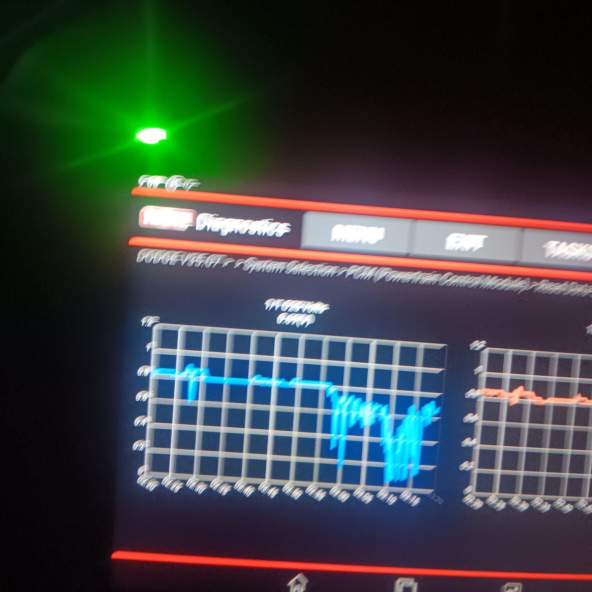

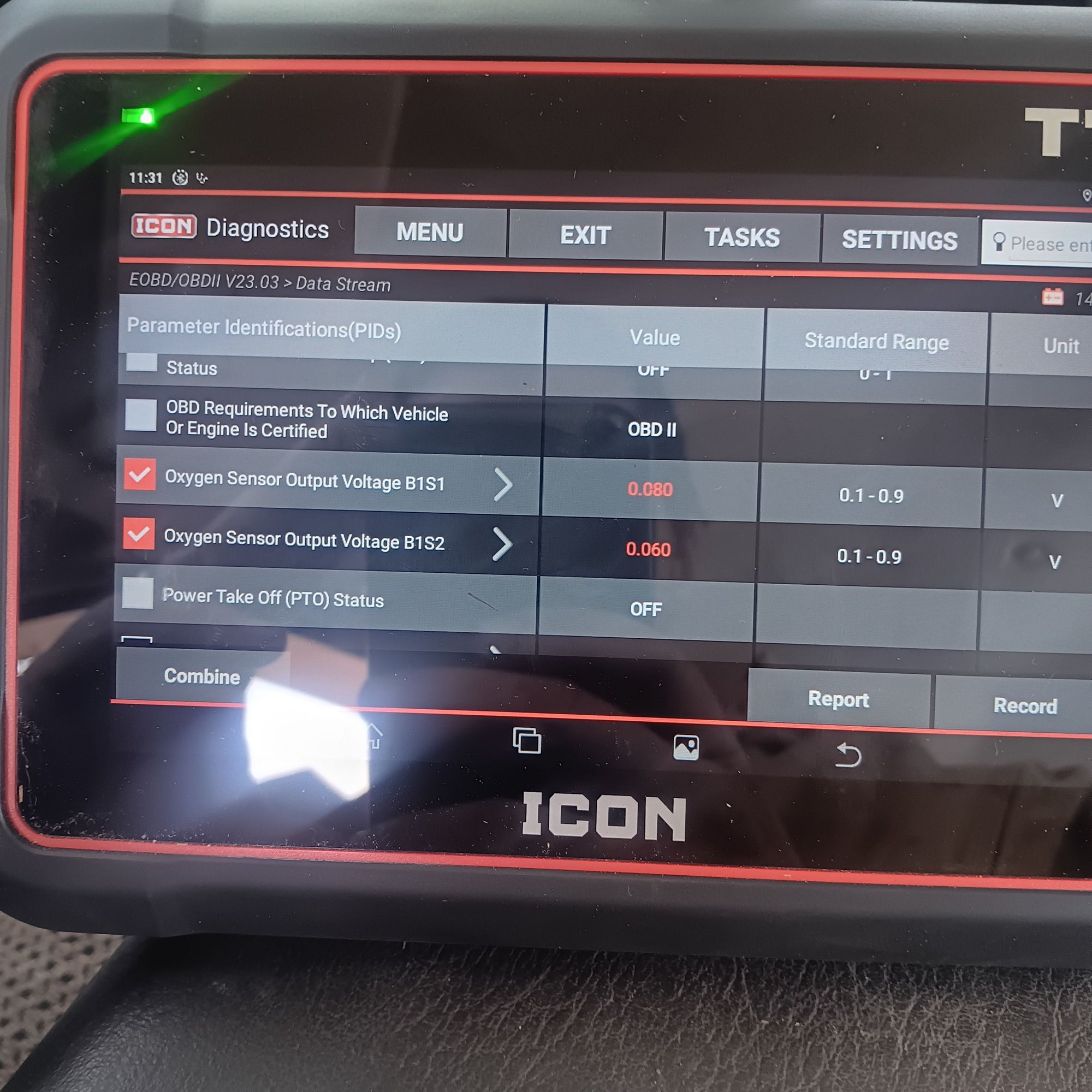

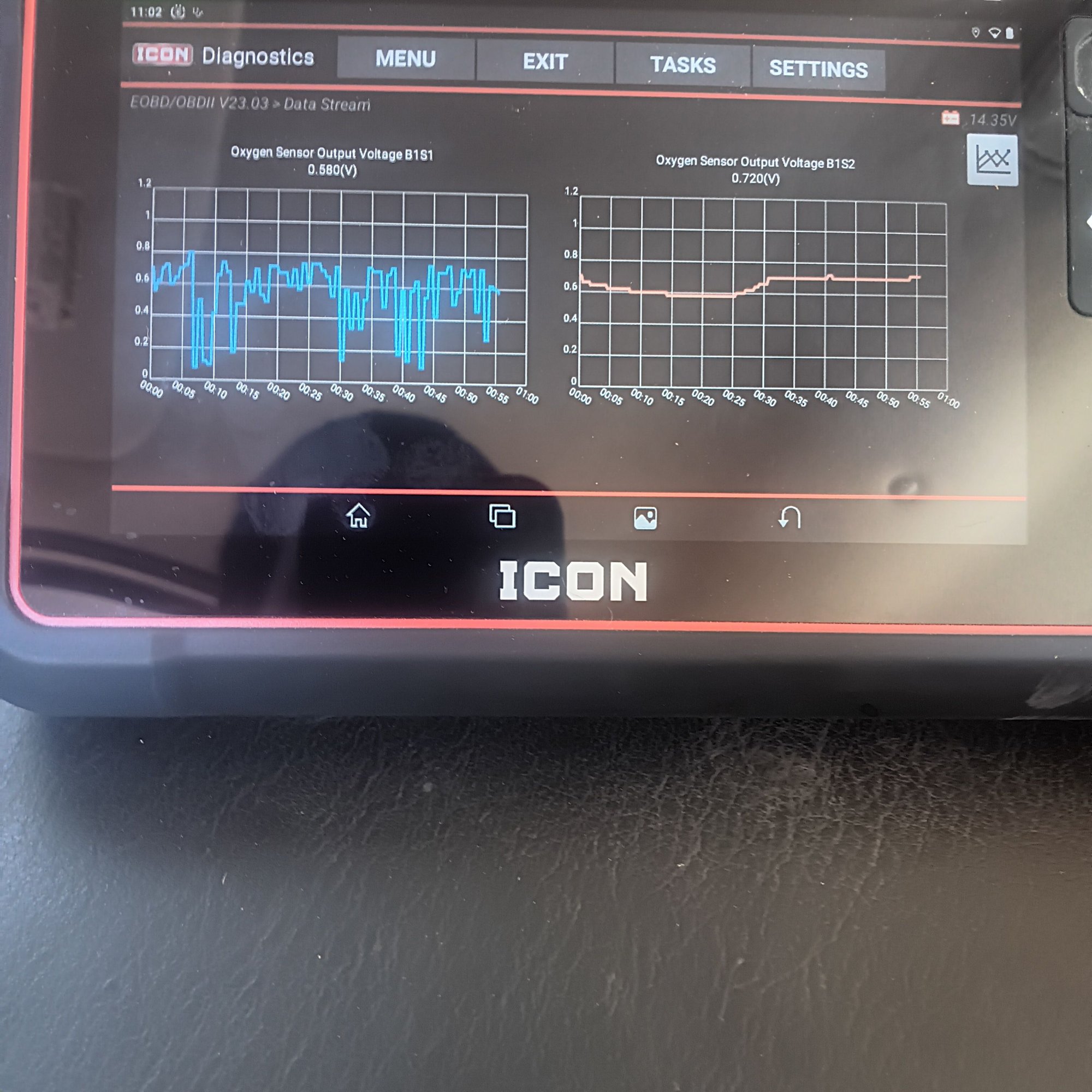

Thats what's wierd and what the last shop couldnt understand is both o2 sensors are saying lean at idle at least but ecu isnt compensating as fuel trims are pretty in range. Then if you give it gas readings get pretty normal up until higher rpms on the highway where upstream flatlines right around where downstream sits at .7 or so. If just reving to high rpms it reads fairly normal but even when getting normal patterns still hits .008 on the drop. Im using a icon t7 so i dont know if it is not processing fast enough cuasong the flatline on the graph when high rpms on highway or if its really flat lining. I swapped maps with my other truck and didnt have much luck but is there a way to test it? My tablet is showing map preassure at 15 then up to 20 when reving and voltage is 1.5 to 1.7.
this is a pic of a high rpm flatline then where pattern returns is at the shift.
This one is cruising then romped on it where it flattens out
Thats at idle it will fluxuate to like .2 max but usually stays low

Not sure if going really lean at idle is normal, or not.... GM did that back in the OBDI days, as it helped with gas mileage.
Your graphs actually look pretty normal. The PCM will drop out of closed loop at higher throttle openings, and just run from tables programmed into the PCM.
