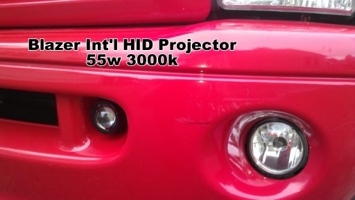

I recommend and am using factory replica housing, use the LMC relay wire harness to power the headlights to get the maximum brightness from halogen bulbs. I prefer brand called Narva Rangepower +50, good focus and brightest bulbs, made in Germany
HID bulbs in the fog lights will melt the clear lens and blind the poor drivers around you. Been there done that.
The factory fogs are cosmetic toys, don't emit a usable amount of light. To make up for the lack of light I added some HID fog lights with the cutoff shields built in. This way I'm not blinding other drivers. They emit more than enough light to supplement the headlights and can always turn them off when facing uphill at a traffic signal.

The factory fogs are cosmetic toys, don't emit a usable amount of light. To make up for the lack of light I added some HID fog lights with the cutoffs built in. This way I'm not blinding other drivers. They emit more than enough light to supplement the headlights and can always cut them off when facing uphill at a traffic signal.

I got mine at theretrofitsource but they are not avail anymore. Can get some JDM that are even better on ebay for $40 with the built in cutoff shield, also need the H3 HID 35watt bulb kit (55watt will melt housing) . These will flood the entire front of your truck with light without blinding anyone.

JDM will throw light at oncoming traffic due to being right hand drive...
Old Feb 24, 2015 | 11:14 PM
beeker's Avatar
beeker
Joined: Dec 2009
Posts: 625
From: Bremerton, WA
You mention a good point. The fogs don't have step in the shield, it's a flat cutoff line
