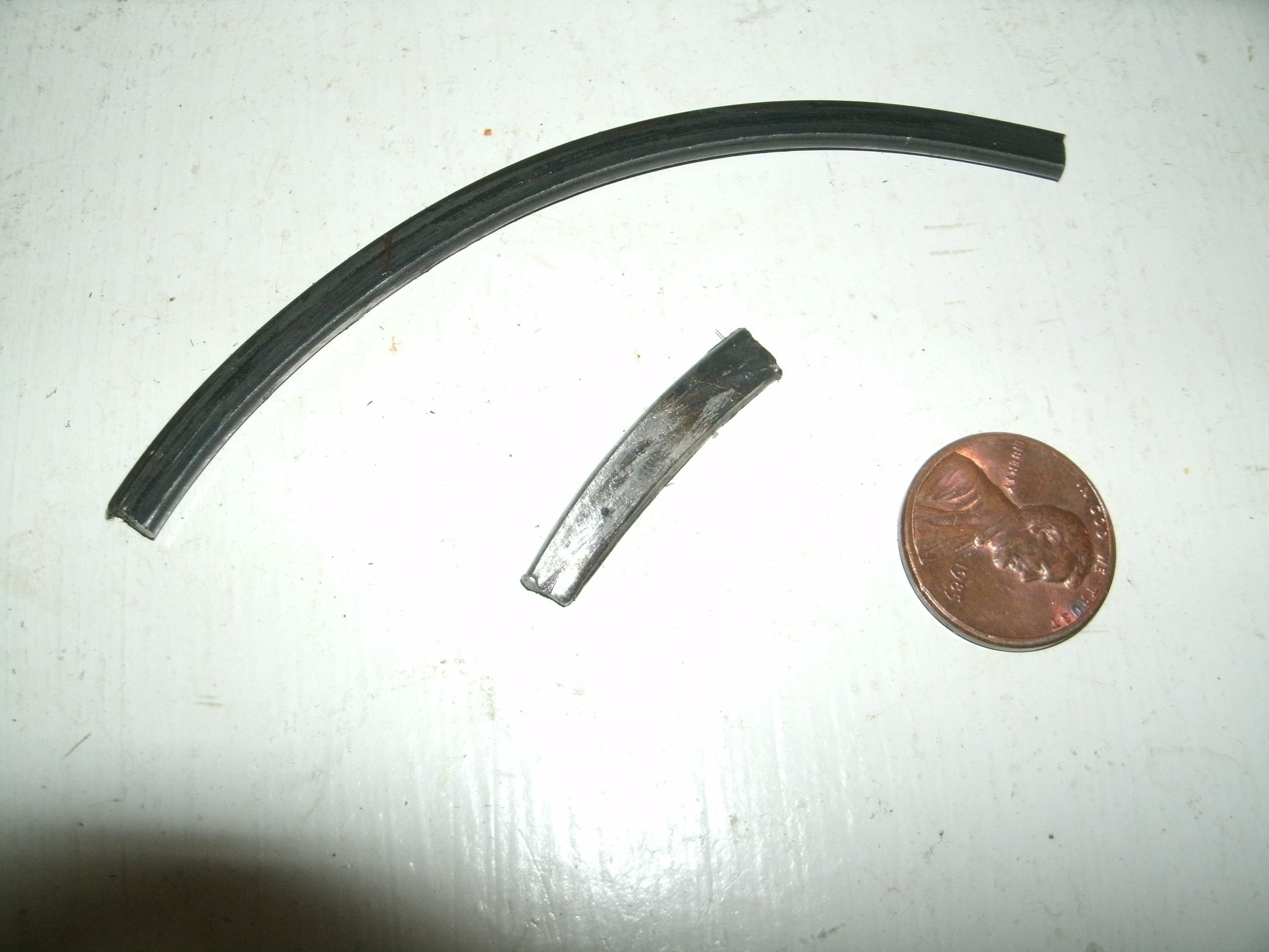

Well Gentlemen I think she's toast. I finally had a chance to pull the pan and found metal shavings, water&tranny fluid mixture, unidentified pieces of steel,and a bunch of soot. Looks like clutch powder. Would someone tell me what these pieces are?

That's the infamous broken overdrive snap ring.

I forgot to mention the penny was not i repeat Not in my pan! Oh never mind i forgot i wasn't on facebook. jk Thanks

Man you'r quick. Thanks . Now time to plan on what t next.If parts are falling off i'd say she's not looking to good. I'll be spending some time reading again.

You need a press to compress the od spring so you can remove/install a new one. You can just pull of the od unit off the back of the trans so you don't need to remove the whole thing.
