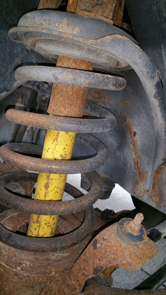

Joined: Apr 2015
Posts: 16
Passenger side shock drivers side looks the same
