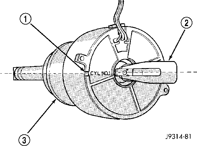

Did the distributor get removed from the new motor at all? Verify that the distributor is pointing at the mark in the picture above when it's at the top of the compression stroke. If it was removed, it's possible it was reinstalled in the wrong orientation.
