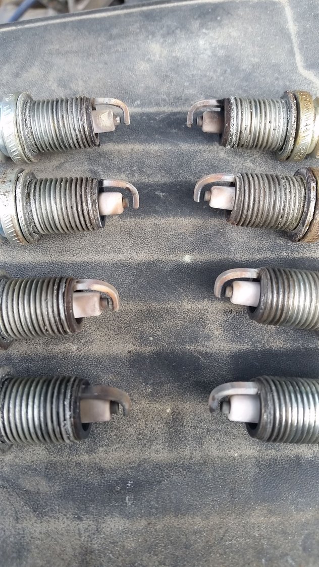

HeyYou.... Sorry it took so long to post pics. I lead a busy life at times. Haha
Here are the pics of plugs. They are laid out just as you would be looking at the motor.
I stand corrected on my other truck. Autolite 5224
Champion RC12LC4

1, 3, and 5 look like they are running lean. Have you fixed your plenum yet?
