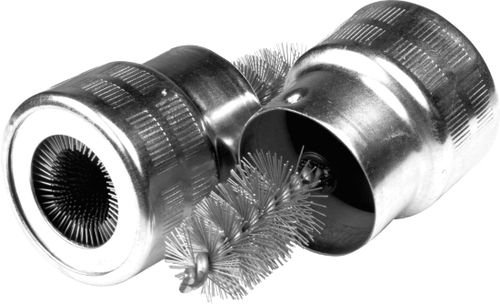

Originally Posted by Moparite
Clean your terminals! These do wonders.
Well this is all it took lol. I overlooked the simple stuff because my clamps and battery are relatively new, and they were on tight. I was also confused because after a failed attempt at starting everything would quit working not just the starter motor . I'll remember all the other tech given too so I'm ready for anything next time haha.
