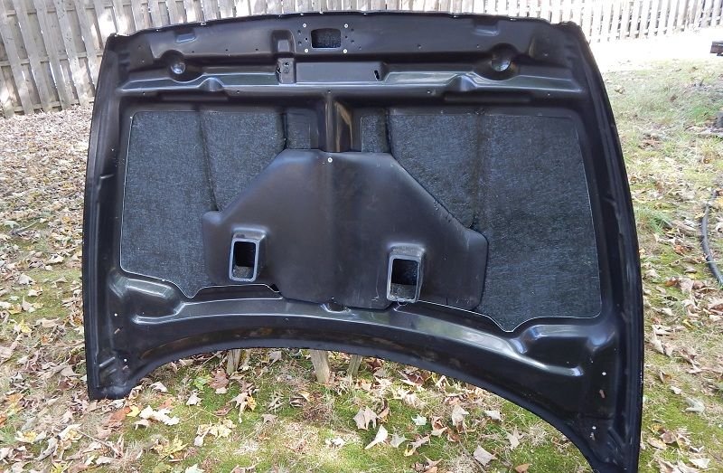

Buy one of these...

Buy one of these...
From where?

This was brought up before, I don't know if they still sell the the true "ram air" set up anymore. There is a air cleaner piece that goes on the throttle body(extra cost) and it was not supplied with the hood. When i bought this there was two different hoods, The ture ram air hood and the hood just for looks. Only one listed now. ???
https://www.aarqualityfiberglass.com...001-ram-air-rt
