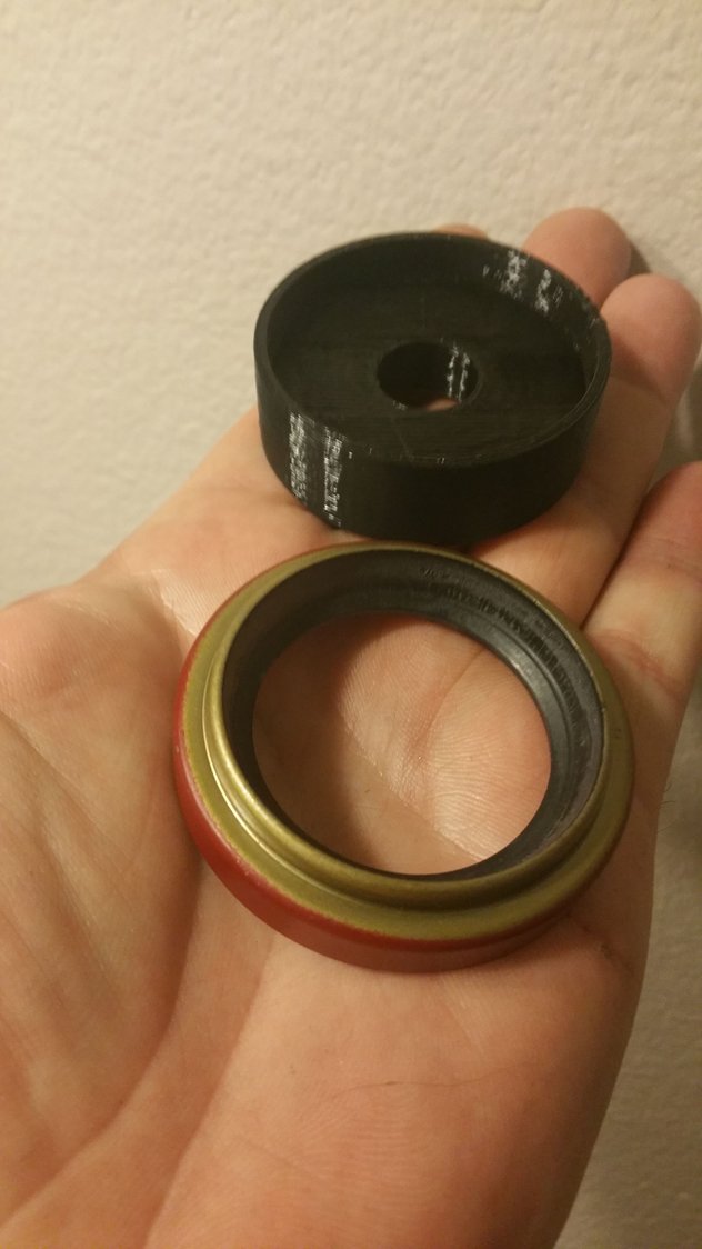

For anyone that needs a tool to replace the passenger side seal on on a 2nd gen ram, I made my own tool on my 3d printer to install one. All you need is all thread some nuts and the piece I can print for you cheap. Yes it's plastic but works like a champ.
Just run all thread through it with a nut and bam. Actually I just calculated my cost to print these on my 3d printer. It cost 80 cents to print. I'll make one for anybody in need of one for free. All I ask is pass them on to others as they need them.
Now that's cool. Love hearing about people that do stuff like this. Never even thought about doing such a thing at a local printer when I did mine and I am no stranger to CAD. Here is my 2 cents worth of how I did this job:
https://dodgeforum.com/forum/2nd-gen...placement.html
The tool you made looks nice and beefy where it counts, I've sent you a PM. Might as well chuck it in the tool pile just in case. Mine are still leak free over a year later.
