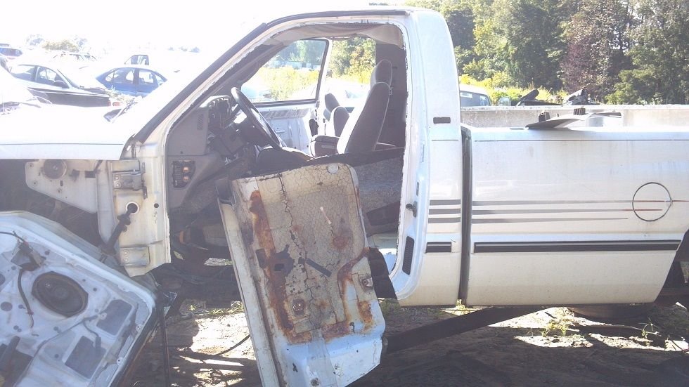

Found a local yard with an acceptable floor.... some light surface and a small spot that I'll mig in a repair. Rest of it is good, better than what I have and should save some time/effort.
Finally put my 18v reciprocating saw to good use. Pic for your entertainment !
Old Sep 23, 2015 | 10:05 PM
Posts: 87,483
Edited your post so the pic shows.

So I did some more cutting on it, but to the part I already cut out.
Used a multi-tool from HF with a putty knife attachment to remove the floor coating and seam sealer.
Then I cut the rocker off and went after the spot welds with my air hammer using a spot welder chisel.
I'm about ready to sand blast the donor... I'm going to fill in the factory holes in the floor, they leak. Probably cut off some of the inner rocker area and replace. But for this area, the donor is pretty good.
Anyone interested in the metal cab support? Its pretty clean w/o rust. I don't need it for mine, but I could remove it cleanly and send it out. Otherwise I'll save time and cut it off in pieces. PM me if you're interested.
