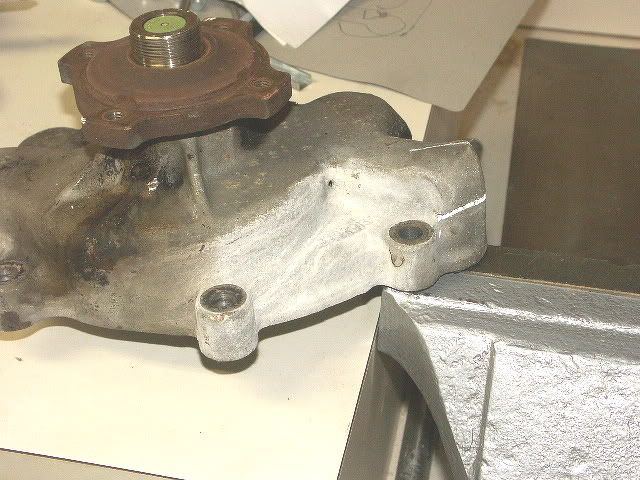

Years ago my pump sprang a leak in the housing. I was about 80 miles away from home and had to limp it back. Luckily i made it to a walmart and bought about 8 gallons of water. Filled it up(with the cap off) and drove it until it started to over heat then stop and wait to refill it again. Made it most of the way but had to refill the gallons at a business that had spicket. Pulled the pump off and this is what i found.
