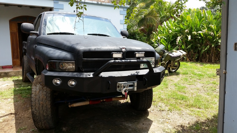

I'm not wanting a dragster, but after the amount of work in this motor, these times are ridiculous. (I can cruise about 120mph at the top end.) But what can the problem be at low end????
2001 5.2 magnum 4x4
Using the TORQUE app, I just timed my truck with and without my superchips tuner:
Stock: 0-60 in 16.0 seconds
1/4 mile in 21.6 seconds @ 70.2 mph
Super chips tuned: 0-60 in 15.5 seconds
1/4 mile in 21.3 seconds
*sounds like the tuner was a waste of money
Here are my mods (nothing left I can do)
-aluminum plenum, kegger mod, throtlebody mod, CAI.
-Odessa aftermarket heads, compcam 20-744-9 camshaft, mopar performance valve springs (dcc-5249464) with valve retainers dcc-4452032.
-short headers with complete 2.5" dual exhaust with t-pipe connection, no cats, unrestricted magnaflow mufflers #10426
-35" tires with 4:56 gear, fox shocks 2.0 w/res
-new 8.2 wires, rotor, and plugs

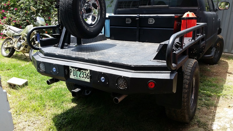

Note: I've shortened the frame, and have custom bed and bumpers, so there is most likely an increase in weight:
edit: The truck shows over 220k miles on the odo, but a full rebuild and all this work was done in the last 3 years. I assume the fuel injectors are original, but it still idles smooth.

The first thing I would do is get a hold of Hemifever or FlyinRyan and have them make you a custom tune. You most likely have a death flash tune on your stock ECM and that is what is killing all your lowend torque. Next the kegger mod takes away from low end torque. What throttle body mod did you do? Have you had your throttle body bored out to 52mm or larger?
Yes the Superchip tuner is a waste of money. You need to contact one of the guys I listed and have them write a custom tune to work with the mods you have done to your engine.
Like what you did with the bed of the truck that is nice.

Wildman, This was originally a longbed, and I shortened the frame and had the flatbed built here. I'm happy as hell with it. I also had to have a gas tank made, since the original was too long afterwards.
