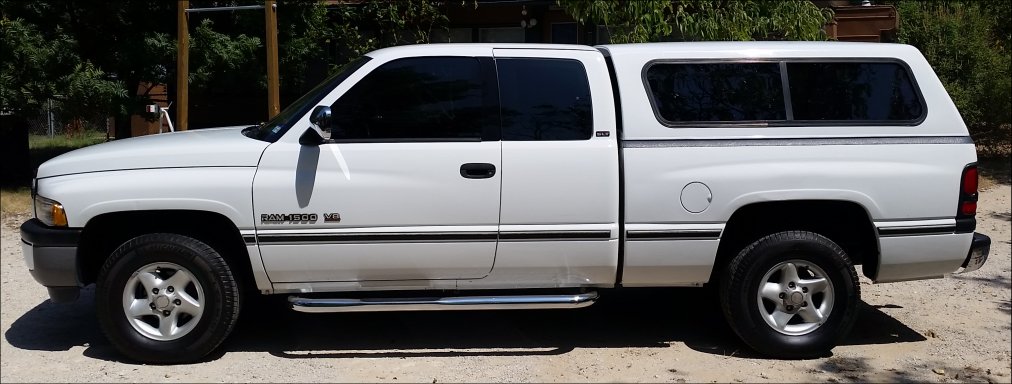

Just washed and waxed too! 70º in December - loving it!
*don't mean to rub it in HeyYou - haha*
