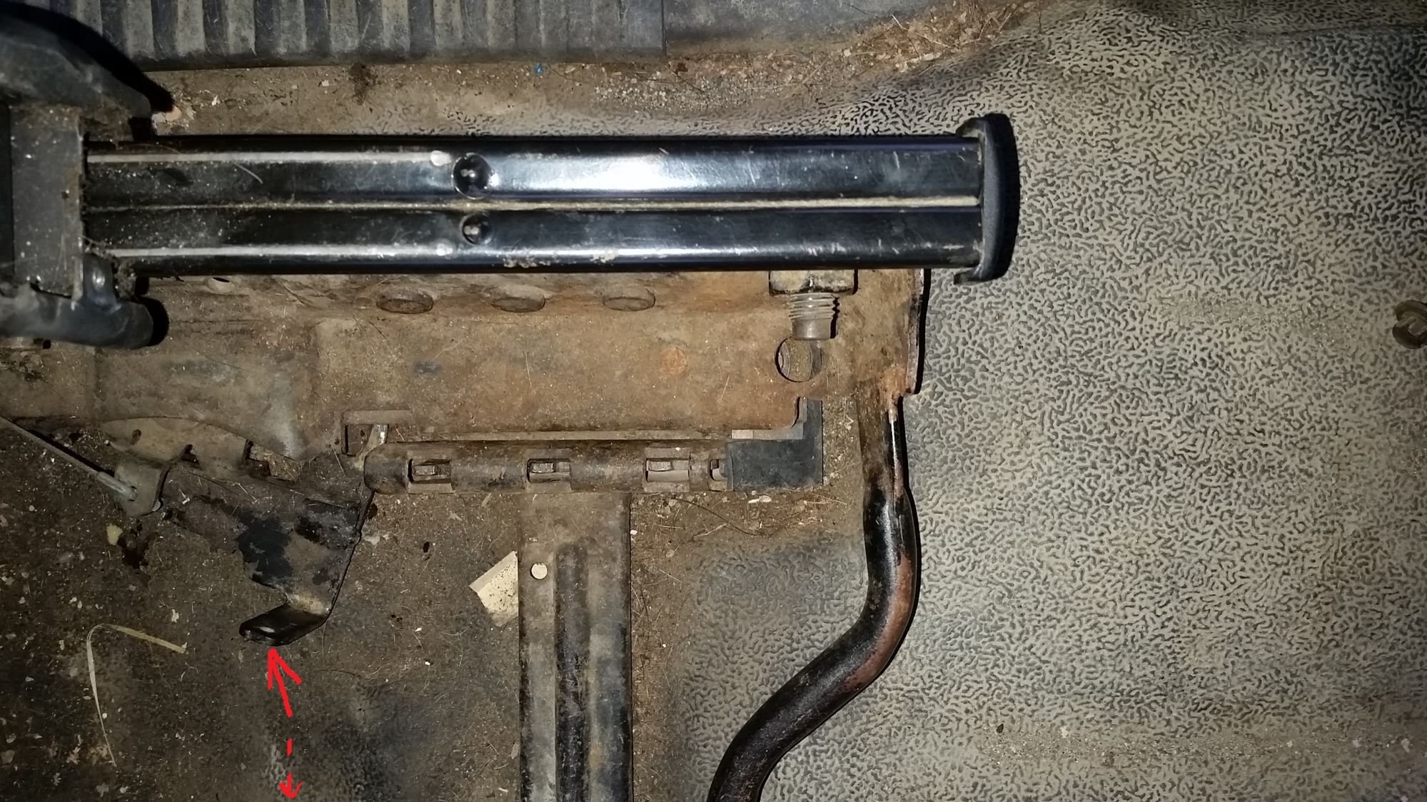

Here is how it was at first
Here is after I finally got it to move and was able to get the rear bolt out

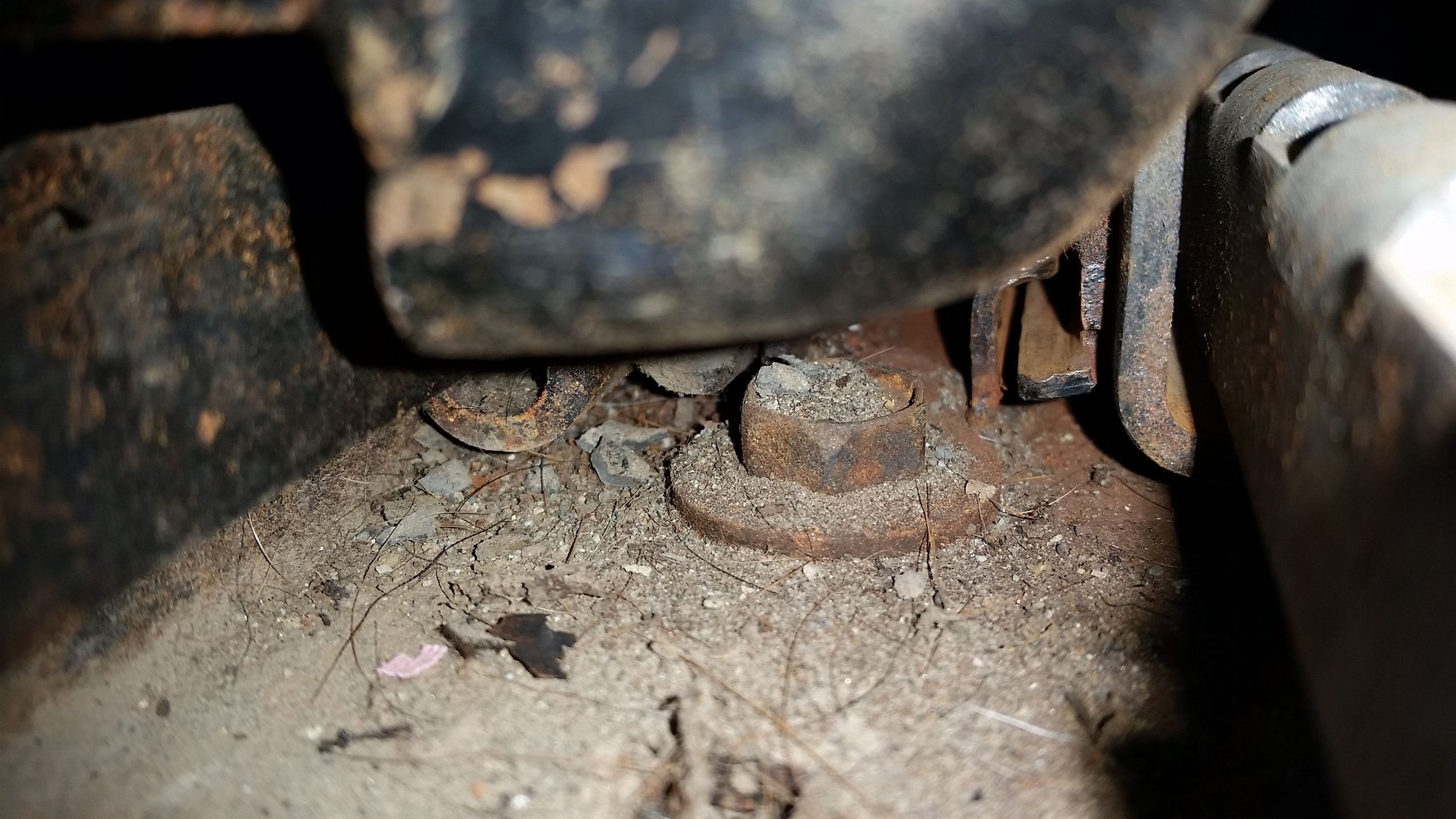

And here is the bolt in question about 2 inches in front of the 1 I took out
I realize its a mess, I was just given this truck a few days ago and yes 40/20/40

That bolt in the 3rd pic is still under the slide rail just out of reach

The release lever in the first picture with the wire on it SHOULD have another wire/cable in the empty hole across from the hole in front.
That wire should connect to the passenger's side rail (inner rail towards center) and pull out to release the seat. Look for the broken wire or hole it goes in and pull out on that part, then try to slide it alond the rail.
