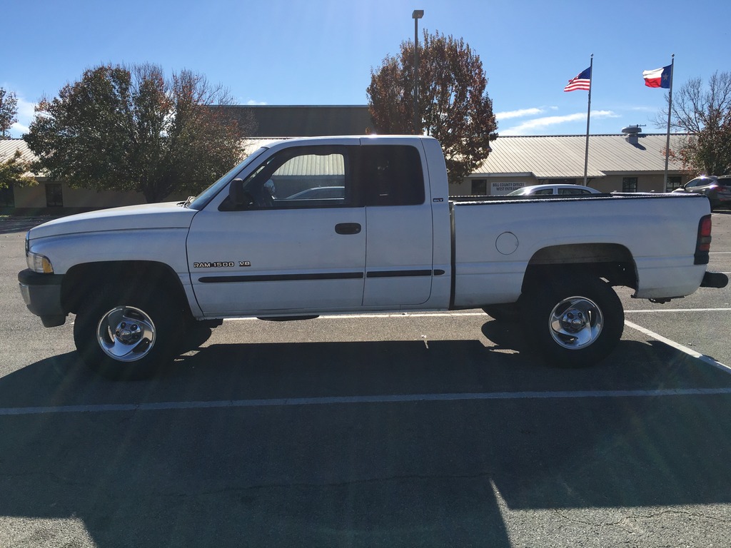

Quad cab doors are different. Check out the bottom corners of my doors and compare to yours:

Yeah I've already discussed it with another member. I knew that but didn't see it, or over read it, in his initial post.
You just wanted to post a picture of your truck.
The back corner of the rear doors is a good reference to the same corner on a standard cab (front door/only door).
Nice lookin' ride by the way.
