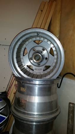

I am waiting on a reply but I have attached a picture of them if that helps.
Attached Thumbnails Wheel and Tire advise - 16x11 on stock suspension-centerline-wheels.jpg
